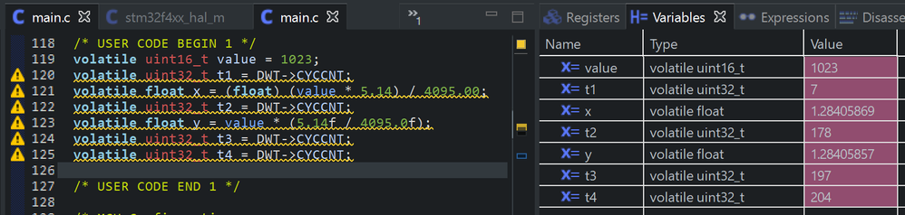

well 2 if check + one addition + on multiply + one division takes less than 50 cpu cycles which at 72MHz it takes about 700 ns. plus HAL_ADC_GetValue(hadc). it shouldn't be a problem I think. but I'll debug and check the exact cycles that it takes.
Just note that HAL_ADC_ConvCpltCallback is not the IRQ handler, but rather is called somewhere within the HAL chain. Also "51.4" is a double, not a float, and operations on doubles are much slower due to no hardware support.
Consider the following code:
 volatile uint16_t value = 1023;
 volatile float x = (float) (value * 5.14) / 4095.00;
 volatile float y = value * (5.14f / 4095.0f);
The calculation of x takes ~164 cycles while the calculation of y takes only ~12.
Piranha
Chief II
adc_val[adc_index] = (float)(internal_ADC1[adc_index] * 5.14) / 4095.00;
These calculations are of a double float type. As F4 has only single float FPU, the code is compiled with software implementation. Actually it's even worse - the multiplication is done as double, then you convert the result to float, then it is converted back to double, the division is done as double and then the result is converted to the type of adc_val element. The whole line definitely takes several hundreds of CPU cycles.
Also, when scaling floating point types by a constant value, there is no sense in doing more than one multiply operation. And dividing with 4095 is just wrong and distorts the data scale. The ADC range is 4096 possible values!
A correct implementation for single float with a single multiplication is this:
adc_val[adc_index] = internal_ADC1[adc_index] * (float)(5.14 / 4096);
 And for this task the HAL/Cube broken bloatware is totally inappropriate...
