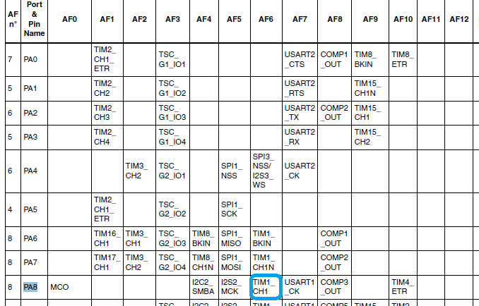

GPIO_PinAFConfig(GPIOA, GPIO_PinSource8, GPIO_AF_12);
AF6 not AF12
opiswahn
Posted on October 05, 2013 at 02:44
ok... that worked, now i've got a signal similar to the one on the F0. THX!

Posted on October 05, 2013 at 03:04
You would want the
http://www.st.com/st-web-ui/static/active/en/resource/technical/document/datasheet/DM00058181.pdf
for your
http://www.st.com/web/catalog/mmc/FM141/SC1169/SS1576/LN1531/PF252054
I'm not a motor guy, you'll need to express your request as a specific signal output.
The[DEAD LINK /public/STe2ecommunities/mcu/Lists/STM32Discovery/Flat.aspx?RootFolder=/public/STe2ecommunities/mcu/Lists/STM32Discovery/TIM4%20CH3%2c%20CH2%2c%20CH1%20now%20working&FolderCTID=0x01200200770978C69A1141439FE559EB459D75800084C20D8867EAD444A5987D47BE638E0F&TopicsView=https://my.st.com/public/STe2ecommunities/mcu/Lists/STM32Discovery/AllItems.aspx&currentviews=63] post immediately below this relates to driving servos on an STM32F3-Discovery
opiswahn
Posted on October 05, 2013 at 13:29
Ah, thats the table i was expecting to find in the F3Discovery manual ;)
Thx dude!
