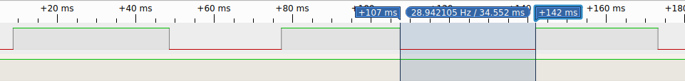

I am attempting to generate a waveform with a period of 33ms. In-between each period, I need to toggle the timer output 5 times with a varying timescale. My initial thought is to do this using a timer in output compare mode and then update the CRR register with the 5 pulses from the DMA in a circular mode.
  ___________          ___________          ___________
  |   5700  |___3000___|   4700  |___3000___|   10000 |_________________________
  <------------------------------------33ms------------------------------------>
So far, the pin toggles but at intervals that are over the values in the array. Below is the waveform as seen on a logic analyser. I am certain that the input clock is correct at 36MHz and the period should be 33ms.
I have included the following functions to the CubeMX generated code to ensure the timer is started with DMA.
HAL_TIM_OC_DelayElapsedCallback(&htim17);
//enable dma
HAL_TIM_OC_Start_DMA(&htim17, TIM_CHANNEL_1, (uint32_t*)wave_buffer, 5);
 At this point, I'm not sure what I'm missing as I've followed the steps in the reference manual and application notes to be on par with what I need. I appreciate any help with what I may be missing, thank you.
PS- code is below

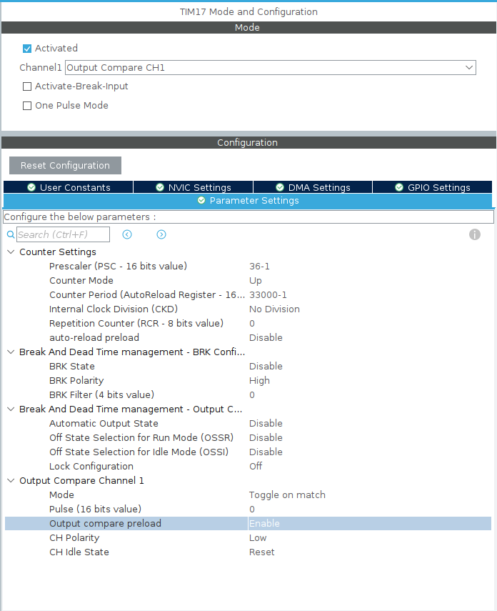

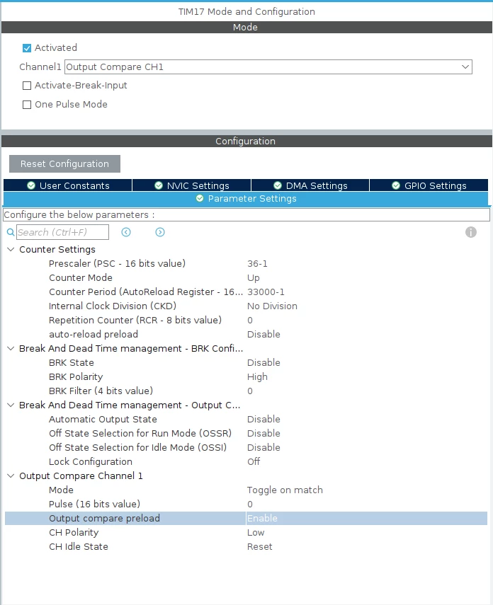

  htim17.Instance = TIM17;
  htim17.Init.Prescaler = 36-1;
  htim17.Init.CounterMode = TIM_COUNTERMODE_UP;
  htim17.Init.Period = 33000-1;
  htim17.Init.ClockDivision = TIM_CLOCKDIVISION_DIV1;
  htim17.Init.RepetitionCounter = 0;
  htim17.Init.AutoReloadPreload = TIM_AUTORELOAD_PRELOAD_DISABLE;
  if (HAL_TIM_Base_Init(&htim17) != HAL_OK)
    Error_Handler();
  if (HAL_TIM_OC_Init(&htim17) != HAL_OK)
    Error_Handler();
  sConfigOC.OCMode = TIM_OCMODE_TOGGLE;
  sConfigOC.Pulse = 0;
  sConfigOC.OCPolarity = TIM_OCPOLARITY_LOW;
  sConfigOC.OCNPolarity = TIM_OCNPOLARITY_HIGH;
  sConfigOC.OCFastMode = TIM_OCFAST_DISABLE;
  sConfigOC.OCIdleState = TIM_OCIDLESTATE_RESET;
  sConfigOC.OCNIdleState = TIM_OCNIDLESTATE_RESET;
  if (HAL_TIM_OC_ConfigChannel(&htim17, &sConfigOC, TIM_CHANNEL_1) != HAL_OK)
    Error_Handler();
  __HAL_TIM_ENABLE_OCxPRELOAD(&htim17, TIM_CHANNEL_1);

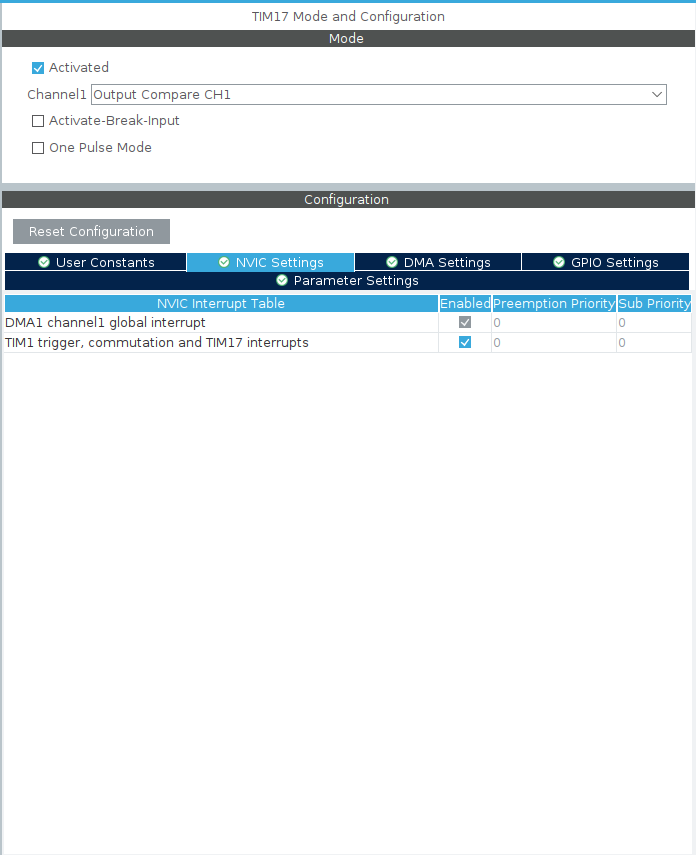

  /* DMA interrupt init */
  /* DMA1_Channel1_IRQn interrupt configuration */
  HAL_NVIC_SetPriority(DMA1_Channel1_IRQn, 0, 0);
  HAL_NVIC_EnableIRQ(DMA1_Channel1_IRQn);

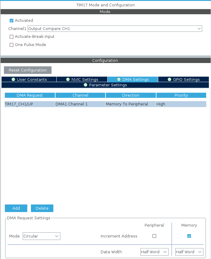

    hdma_tim17_ch1_up.Instance = DMA1_Channel1;
    hdma_tim17_ch1_up.Init.Direction = DMA_MEMORY_TO_PERIPH;
    hdma_tim17_ch1_up.Init.PeriphInc = DMA_PINC_DISABLE;
    hdma_tim17_ch1_up.Init.MemInc = DMA_MINC_ENABLE;
    hdma_tim17_ch1_up.Init.PeriphDataAlignment = DMA_PDATAALIGN_HALFWORD;
    hdma_tim17_ch1_up.Init.MemDataAlignment = DMA_MDATAALIGN_HALFWORD;
    hdma_tim17_ch1_up.Init.Mode = DMA_CIRCULAR;
    hdma_tim17_ch1_up.Init.Priority = DMA_PRIORITY_HIGH;
    if (HAL_DMA_Init(&hdma_tim17_ch1_up) != HAL_OK)
      Error_Handler();
    /* Several peripheral DMA handle pointers point to the same DMA handle.
     Be aware that there is only one channel to perform all the requested DMAs. */
    __HAL_LINKDMA(htim_base,hdma[TIM_DMA_ID_CC1],hdma_tim17_ch1_up);
    __HAL_LINKDMA(htim_base,hdma[TIM_DMA_ID_UPDATE],hdma_tim17_ch1_up);
    /* TIM17 interrupt Init */
    HAL_NVIC_SetPriority(TIM1_TRG_COM_TIM17_IRQn, 0, 0);
    HAL_NVIC_EnableIRQ(TIM1_TRG_COM_TIM17_IRQn);

4 REPLIES 4
Sarra.S
Hello @daded.1
You're on the right track with using HAL_TIM_OC_Start_DMA(), this function allows you to update the CCR with the values provided in the wave_buffer array using DMA and starts the timer in output compare mode.
In the DMA config, the DMA needs to be set to circular mode to reload the wave_buffer values when it reaches the end automatically.
Also, you may want to implement HAL_TIM_OC_DelayElapsedCallback to handle the DMA interrupt on each toggle event
To understand how every function works, you can look at its prototype in the stm32f3xx_hal_tim.c file and read the comments explaining its parameters
Regarding refreshing your memory, refer to the following links:
Description of STM32F3 HAL and low-layer drivers
STM32CubeMX for STM32 configuration and initialization C code generation
Hope that helps!
daded.1
Thank you Sarra.S,
That was very insightful. After reading the manuals and going through the prototypes, I went ahead to enable the timer/dma using
HAL_TIM_OC_Start_DMA(&htim15, TIM_CHANNEL_1, (uint16_t*)wave_buffer, 5);
I ran the code and I can see the output pin toggle, but it is nothing compared to the expected pulses. On reset, it just toggles at a period of 2 times the set period.
As for DMA config, I have that set as follows in the CubeMX generated file
    /* Peripheral clock enable */
    __HAL_RCC_TIM15_CLK_ENABLE();
    /* TIM15 DMA Init */
    /* TIM15_CH1_UP_TRIG_COM Init */
    hdma_tim15_ch1_up_trig_com.Instance = DMA1_Channel5;
    hdma_tim15_ch1_up_trig_com.Init.Direction = DMA_MEMORY_TO_PERIPH;
    hdma_tim15_ch1_up_trig_com.Init.PeriphInc = DMA_PINC_DISABLE;
    hdma_tim15_ch1_up_trig_com.Init.MemInc = DMA_MINC_ENABLE;
    hdma_tim15_ch1_up_trig_com.Init.PeriphDataAlignment = DMA_PDATAALIGN_HALFWORD;
    hdma_tim15_ch1_up_trig_com.Init.MemDataAlignment = DMA_MDATAALIGN_HALFWORD;
    hdma_tim15_ch1_up_trig_com.Init.Mode = DMA_CIRCULAR;
    hdma_tim15_ch1_up_trig_com.Init.Priority = DMA_PRIORITY_HIGH;
    if (HAL_DMA_Init(&hdma_tim15_ch1_up_trig_com) != HAL_OK)
      Error_Handler();
