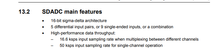

Here is a snippet from page 231
Is it 50Khz or 16.6Khz for a differential channel

you can get 50ks from one ADC - single or diff. input .
so using 2 ADCs in interleaved mode can make 100ks , also on diff. inputs.

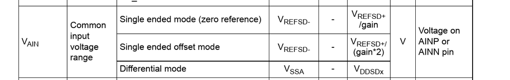

you can put inputs together as in single ended in, just respect the common mode input range (see in ds )

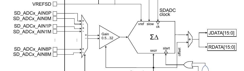

as you can see (15.3 sdadc...) each ADC has its diff/input mux in front:

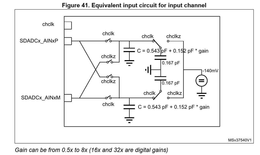

I was just about to post the same image as Ascha, there seems to be a differential amplifier/gain stage just before the ADC, see page 233 of RM0313.

good...and i see on quick look at rm no fast/slow channels, only (fast) SAR ADC seem to have such.
see input mux for a channel, always +/- inputs there, can only choose to use them or leave one input at gnd -> single ended then.
so anyway inputs have diff. input stage:

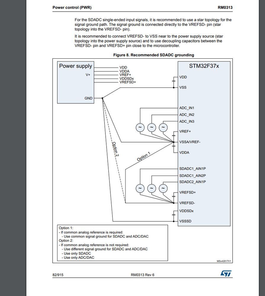

and look for optimum ground ...->

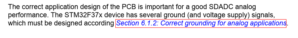

Dear Ascha.3 many thanks I will read and study Section 6.1.2 Correct Grounding for Analog applications
