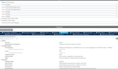

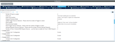

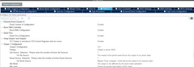

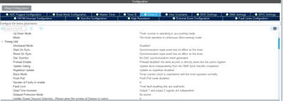

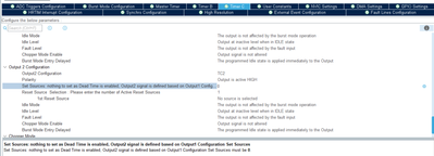

All related to the deadtime settings are disabled, but the Set Source of Output 2 can't be set up. It keeps constant 0, and says the deadtime is enabled? why???

All settings related to dead-time are disabled, but the Set Source for Output 2 still cannot be configured. It stays at 0 and the tool says that dead-time insertion is enabled. Why?

Thanks. The MCU I’m using is the STM32G474RET6. Sorry for not mentioning it earlier.

Hello ​@valeky
This issue has been fixed in the latest version of STM32CubeMX 6.18.0
Download STM32CubeMX6.18.0 from  here
