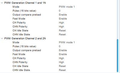

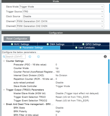

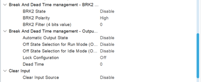

I am trying to implement them in the STM32CubeMX/IDE, but it's not working. Here is my CubeMX configuration
TIM1:
TIM8:
In the CubeIDE, I also added the following lines after the initialization:

Unfortunately, it is not working. TIM1-CH1/2 and TIM8-CH1/2 are in sync with no shaft shift, despite the TIM1->CCR3 = 10 that should shift it by 10 counts.
Can anyone help me figure out what I'm doing wrong?

For the master configuration: TIM1_CH3, configure it as "output compare with no output", select the trigger event selection as output compare CH3 (as you did in the screenshot) and in the output compare mode select it as "active on level match" as you want their rising edges to always be the same.
I don't see an issue with your slave configuration.

Trigger mode of Slave-mode controller (as set in TIMx_SMCR.SMS) upon arrival of TRGI sets TIMx_CR1.CEN.
It means, that you don't want to set TIMx_CR1.CEN in the slave timer "manually" in your code, you want it to be set through the TRGO-TRGI mechanism from the master timer.
It also means, that if you want to repeat this process automatically, you have to use the One-Pulse mode in slave timer (i.e. TIMx_CR1.OPM = 1), where TIMx_CR1.CEN is cleared by hardware upon Update (i.e. after each period of timer).
In other words, you want the slave timer to generate only one pulse per trigger, and then trigger it repeatedly from the master timer.

Just set TIM8_CR1.OPM = 1 and leave TIM8_CR1.CEN = 0.
If you've set properly TIM8_SMCR to be triggered from TIM1 and in Trigger mode, the trigger from TIM1 will start the TIM8 in hardware, it will generate one pulse, and as it's in one-pulse mode, it will stop itself.
