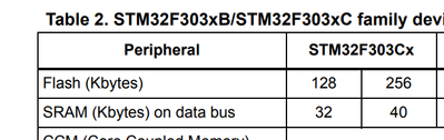

the STM32F303CCT6 has 256kB Flash, while STM32F303CBT6 has only 128kB.
So a binary for STM32F303CBT6 should fit
I see no other differences. The problem should be somewhere else.
P.S.: ... and 40kB SRAM instead of 32, but should be no harm as well.

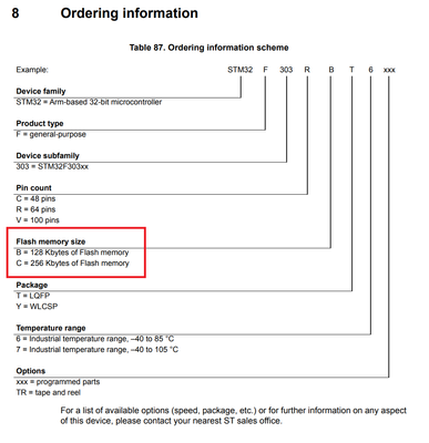

This information is provided in the product datasheet / Section 8 Ordering information:
and in Table 2. STM32F303xB/STM32F303xC:
The difference is in the Flash and RAM size . I don't see other differences. So if you have a hex file working fine on CBT6 that should work on CCT6.
Are you sure the boards are OK? boot pin? power? etc ..
