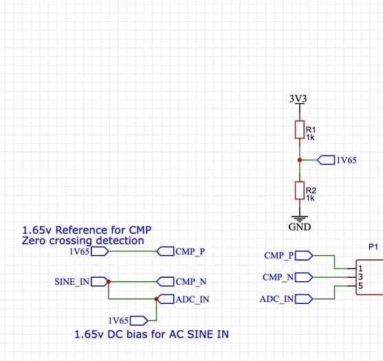

I'll try to better explain it before drawing it out:
On the ADC input, I need to DC offset the AC signal, so that it always floats above ground, so I will need to provide 1.65v dc to the ADC input, so that it can accept an ac signal.
The Comparator needs two signals, the input signal, and a reference voltage for the "zero point"
Input signal would be the same signal going into the ADC (which is already DC offset)
But the reference voltage for zero crossing detection would be half of Vcc(3.3v), in this case also 1.65v
The question is, can I use a voltage divider for example, and feed both inputs (ADC and comparator reference) with the same voltage path, or should I isolate them using op-amps or transistors etc (some active form of signal isolation)
Per the logic, I would say they need to be isolated.

I do it - just for fun - on a F303 to build a mini - DSO.
Virtual ground for ADC and comp input is 1/2 VDD, comp negative input comes from DAC output. So I can adjust trigger level.
And you can not use same input pin for different functions at same time, so one is ADC input and comp positive input on another, connected together.

Okay so here is my example.
I have a voltage divider to generate 1.65v which is to be used for both the ADC DC bias as well as the CMP reference voltage for zero point.
But in the circuit below, we are actually connecting all signals together, which might lead to unexpected behavior on the comparator.
That's why I figured that using a buffer between ADC/CMP_N and CMP_P would solve the potential issue
