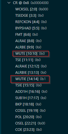

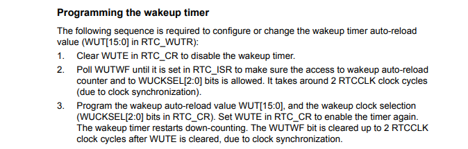

I am currently working on a Rust implementation of a STM32f3 Discovery Board hal. As mentioned in the documentation, I am doing the following:
Before setting the WUTE bit, I also set the WUTIE bit. My ultimate goal is the trigger a 1 second periodic interrupt using the RTC. The moment I set the WUTE bit, I see all of the bits that I have just set in the RTC_CR register go low, while the RTC_WUTE bit remaining high. Is this normal? I tried testing out the code to see if the interrupts are active, to no avail.

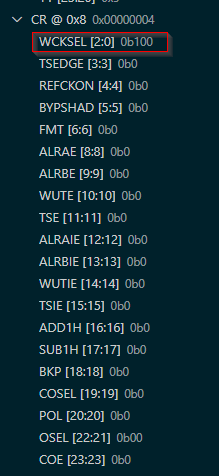

BEFORE (I select LSI as clock source):

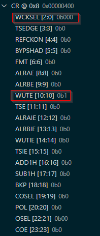

AFTER ( after setting WUTE, WCKSEL is set back to 0b000 for some reason):
Moreover, when I set WUTIE to allow for the hardware interrupt, it then clears the WUTE bit:
This is the behavior that I was asking about. Is it normal for the signals to be cleared like that?
