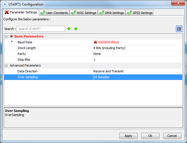

i want a baud rate of 5 mbps on UART1/UART6 on STM32F207 Nucleo Board (As per reference Manual UART1 & UART6 can have baud rate up to 7.5 Mbps). However when i am configuring in STM Cube MX i am getting baud rate of 3.7 mbps max for both UART1 & UART6. I have checked clock configuration many times.
HCLK= 120 MHz, APB1= 30MHz, APB2=60 MHz exactly. In Addition to this i also tried to give Input frequency of 25MHz (26 MHz max).
Still i am unable to cross 3.7 Mbps (max possible value as per Cube Mx)
So can anybody suggest me possible solution??.

Just an idea ...

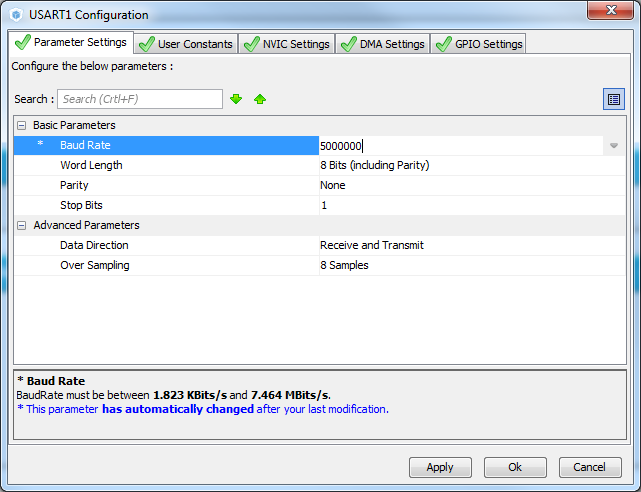

Highest baud rates values require to have Oversampling set to 8 (not 16).
Using an APB2 clock at 60 Mhz, with an USART oversampling set to 16, max baud rate that could be achieved is corresponding to 60/16 = 3.75 Mhz, so more or less what you experienced.
Could you check Oversampling setting value when configuring your USART in Cube MX (8 or 16) ?
If 16, could you try 8 instead?

as it is already said by
Cadier.Guenael
try to set
Oversampling to 8 ,to have
Highest baud rates value.
Common programmable transmit and receive baud rate of up to 7.5 Mbit/s whenthe APB frequency is 60 MHz and oversampling is by 8
-Nesrine-

Guenael Cadier
Posted on January 23, 2017 at 16:10
Just some pics to highlight what i meant :
Here is CubeMx configuration window when trying to apply 5Mhz baudrate using OverSampling rate set to 16 samples :
Now, selecting oversampling 8, extends possible baudrate range and allow reaching 5Mhz :
Regards
Guenael

Posted on January 23, 2017 at 16:57
60 MHz / 16 = 3.75 MHz
OVER8 mode will get you higher
For high baud rates of specific value you'd likely want to start will a close multiple as the granularity of the clock becomes more dominant. High asynchronous rates aren't particularly robust/reliable, consider synchronous methods, and ones with integrity checking designed in.
Posted on January 23, 2017 at 16:15
Thank you so much..I got the Point..
