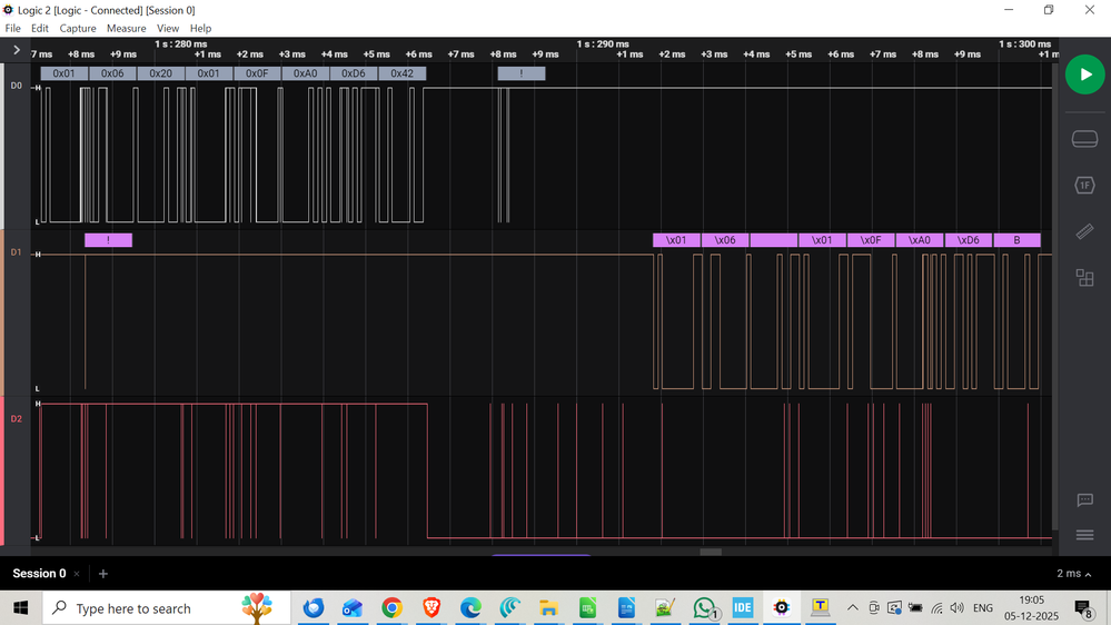

I am trying to configure STM32 Nucleo-64 G070RB Board as Modbus RTU Master to send commands to a slave and receive response. I have connected MAX485 - TTL to RS485 board. Powered with 5V, DE and RE connected to USART1 DE Pin. Board's A and B are connected to slave (VFD) at a distance of less than 2 meters.
I am able to send commands and slave works fine. The response from salve received is not echo of the command as expected. UART reports Parity error and Noise error :1h and 2h => 3h.
When the slave was connected to PC and same commands were sent using QModBus, slave works the same way (as expected) and response received is correct (echo of the command).

It works fine now. D0 is data sent by STM32 (Modbus RTU Master) and D1 is reply data from VFD and D2 is DE. Rewired and cleaned by merging with previous working code. Issue was probably with
1. Wiring of Rx signal from STM32 to MAX485 (TTL to RS485 board) and / or to VFD.
2. Delay
Updated code to send and Modbus RTU frame is:
tx_status = HAL_UART_Transmit(huart, request, 8, 100);
while (__HAL_UART_GET_FLAG(huart, UART_FLAG_TC) == RESET);
rx_status = HAL_UART_Receive(huart, response, 8, 200);
Thank you all for the inputs. Issue can be closed.

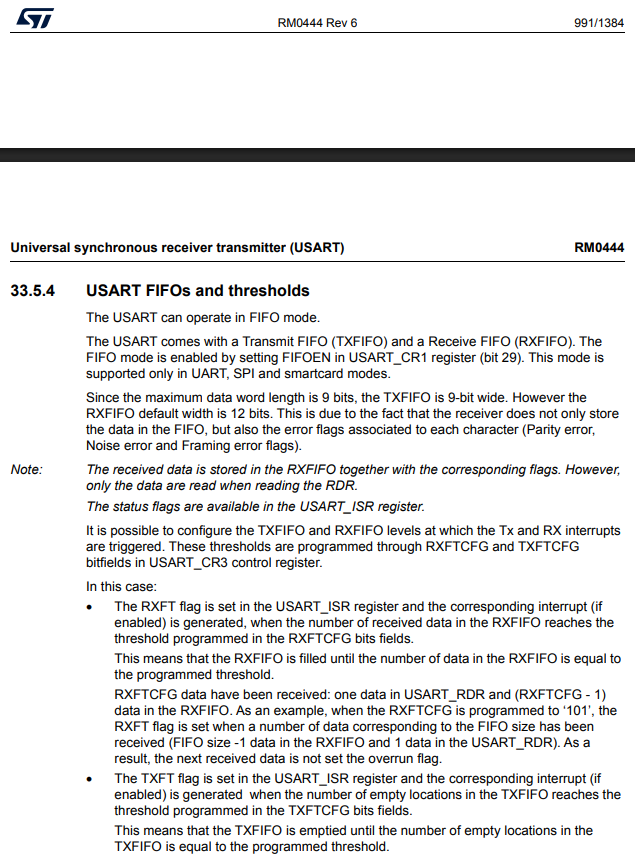

What is the UART receive buffer size?
See the Reference Manual for details of the UART and its operation.
