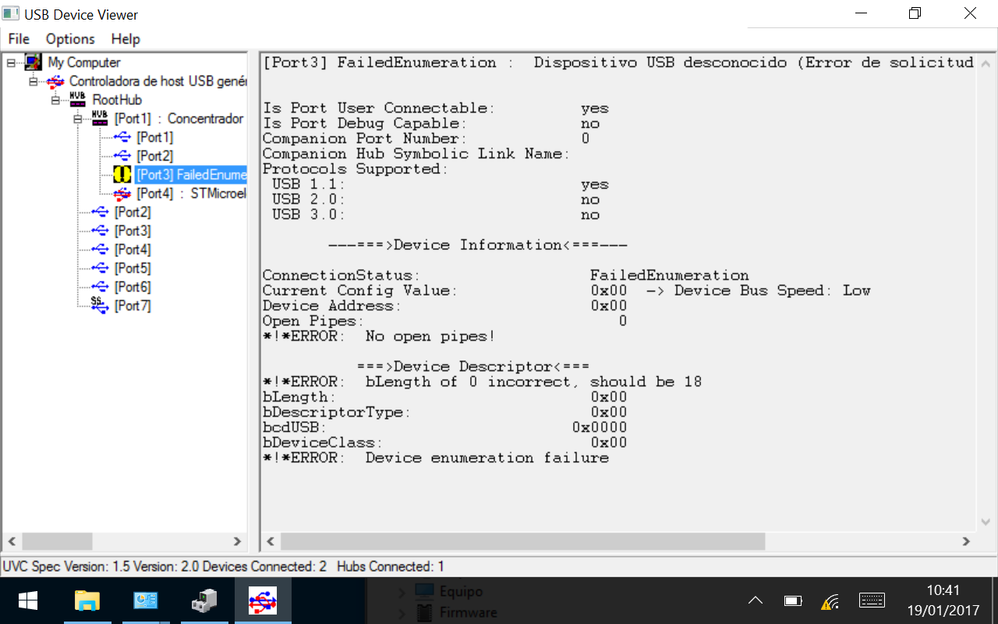

Posted on January 20, 2017 at 10:13
Hi
DAHMEN.IMEN
I discard problems with the HUB and the possible exchange of D + for D-, and the problem persists.

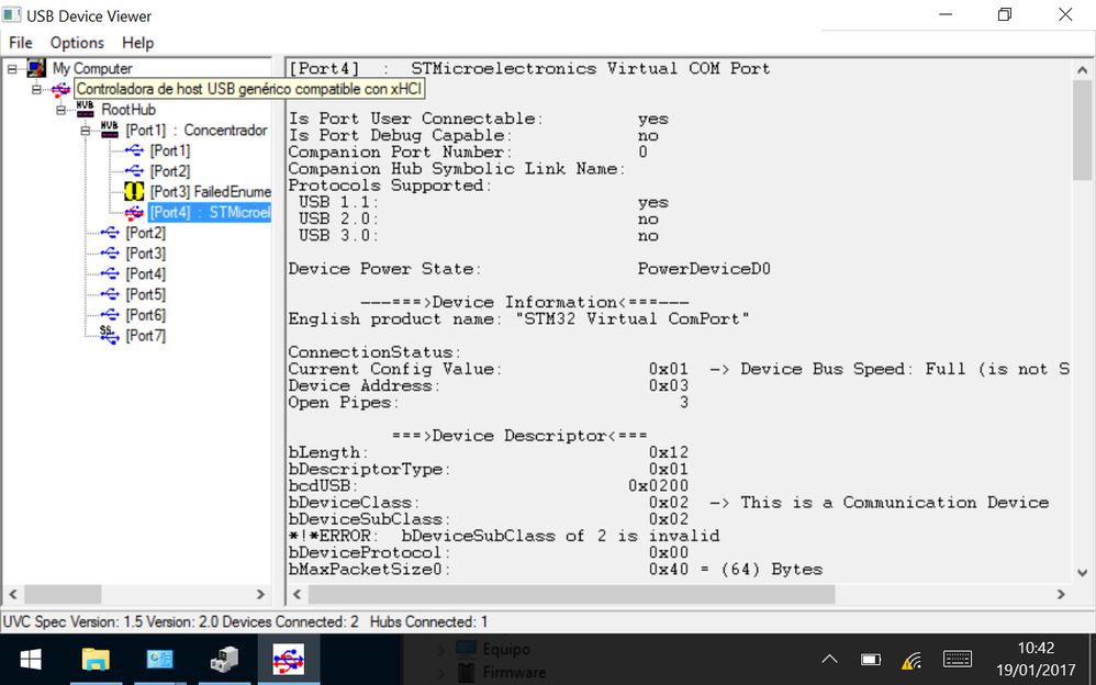

I've done captures with USBview to see what kind of problem I have.
STM32F103 working fine:
Now the STM32F107, with the communication problems.
I have tested by placing the pull-up resistor at 107, but that way it stops working the
I created the software with CubeMx in both micros, so I imagine the problem doesn't come from here.
Thank you in advance.

Posted on January 23, 2017 at 13:50
Solved!
Isolating the problematic micro, and redoing the code again the tablet is detecting the micro 107, I will continue working on it.
