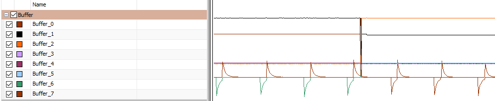

I have DMA setup to read 8 channels of the ADC into a fixed buffer and I'm having an issue where after an extended period of time (usually hours) the ADC channels are read into the wrong buffer index. The failure usually results in the destination index shifting back 1 from the correct index for a small amount of time (<100ms), and then the destination index shifts forward 1 from the correct index for an extended period of time (a couple of minutes). After that the issue seems to heal itself. I have the readings sent out over CAN in a 20ms periodic message and can observe the failure there.
This is high level view of the failure where you can observe the indexes switching.0693W00000FBEl8QAH.png

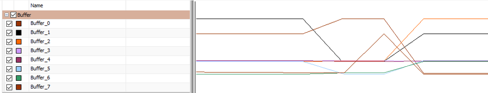

This is a zoomed-in view of the point in time where the failure occurs.

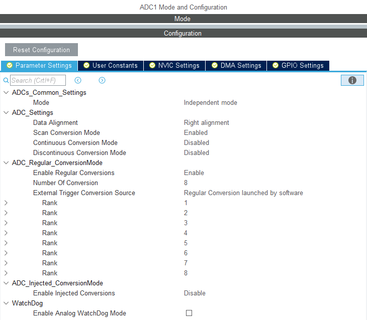

The ADC and DMA settings are configured in Cube IDE.
The relevant generated code in main.c is:

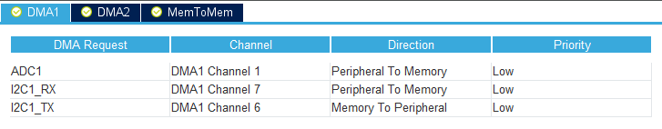

  /* DMA interrupt init */
  /* DMA1_Channel1_IRQn interrupt configuration */
  HAL_NVIC_SetPriority(DMA1_Channel1_IRQn, 7, 0);
  HAL_NVIC_EnableIRQ(DMA1_Channel1_IRQn);
  /* DMA1_Channel6_IRQn interrupt configuration */
  HAL_NVIC_SetPriority(DMA1_Channel6_IRQn, 7, 0);
  HAL_NVIC_EnableIRQ(DMA1_Channel6_IRQn);
  /* DMA1_Channel7_IRQn interrupt configuration */
  HAL_NVIC_SetPriority(DMA1_Channel7_IRQn, 7, 0);
  HAL_NVIC_EnableIRQ(DMA1_Channel7_IRQn);

  /** Common config
  hadc1.Instance = ADC1;
  hadc1.Init.ScanConvMode = ADC_SCAN_ENABLE;
  hadc1.Init.ContinuousConvMode = DISABLE;
  hadc1.Init.DiscontinuousConvMode = DISABLE;
  hadc1.Init.ExternalTrigConv = ADC_SOFTWARE_START;
  hadc1.Init.DataAlign = ADC_DATAALIGN_RIGHT;
  hadc1.Init.NbrOfConversion = 8;
  if (HAL_ADC_Init(&hadc1) != HAL_OK)
    Error_Handler();
  /** Configure Regular Channel
  sConfig.Channel = ADC_CHANNEL_9;
  sConfig.Rank = ADC_REGULAR_RANK_1;
  sConfig.SamplingTime = ADC_SAMPLETIME_239CYCLES_5;
  if (HAL_ADC_ConfigChannel(&hadc1, &sConfig) != HAL_OK)
    Error_Handler();
  sConfig.Channel = ADC_CHANNEL_3;
  sConfig.Rank = ADC_REGULAR_RANK_2;
    Error_Handler();
  sConfig.Channel = ADC_CHANNEL_7;
  sConfig.Rank = ADC_REGULAR_RANK_3;
    Error_Handler();
  sConfig.Channel = ADC_CHANNEL_8;
  sConfig.Rank = ADC_REGULAR_RANK_4;
    Error_Handler();
  sConfig.Channel = ADC_CHANNEL_14;
  sConfig.Rank = ADC_REGULAR_RANK_5;
    Error_Handler();
  sConfig.Channel = ADC_CHANNEL_15;
  sConfig.Rank = ADC_REGULAR_RANK_6;
    Error_Handler();
  sConfig.Channel = ADC_CHANNEL_6;
  sConfig.Rank = ADC_REGULAR_RANK_7;
    Error_Handler();
  sConfig.Channel = ADC_CHANNEL_4;
  sConfig.Rank = ADC_REGULAR_RANK_8;
    Error_Handler();
  /* USER CODE BEGIN ADC1_Init 2 */
  /* USER CODE END ADC1_Init 2 */
The DMA is started periodically in software and observed after the transfer complete callback is called.

Another possibility is that somehow one DMA sample is lost. I observed such problem when used maximum sampling rate and a lot of DMA1 transfers (ADC in circular+DAC+UART simultaneously). In some cases UART DMA transfer shifted ADC DMA received buffer by one sample. Problem was solved by disabling ADC external trigger and moving UART to DMA2. Note that in my case ADC was continuously running in circular mode, so there was no any "self healing" and lost samples count accumulated over time as UART data was sent to the computer.
And less likely it may be the problem on the monitoring software side, the one which shows those graphs. If you still have this problem I need to see how Task_ADC() is used, and how I2C DMA or other peripherals with DMA are called.

  • Task_ADC() is called on a 20ms interval by a small function scheduler. I have removed the I2C DMA configurations, so the only thing using DMA is the ADC. I will update if this configuration helps.
