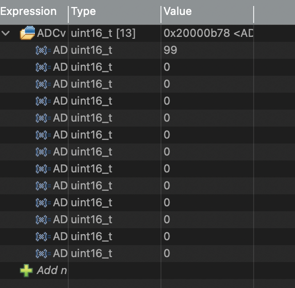

For a STM32F105 project I have ADC1 configured with13 regular conversion channels.
The problem is I only get the first reading and the rest of the buffer stays empty.
It seems the pointer to the buffer array is not correct or the DMA is not incrementing to the next index.

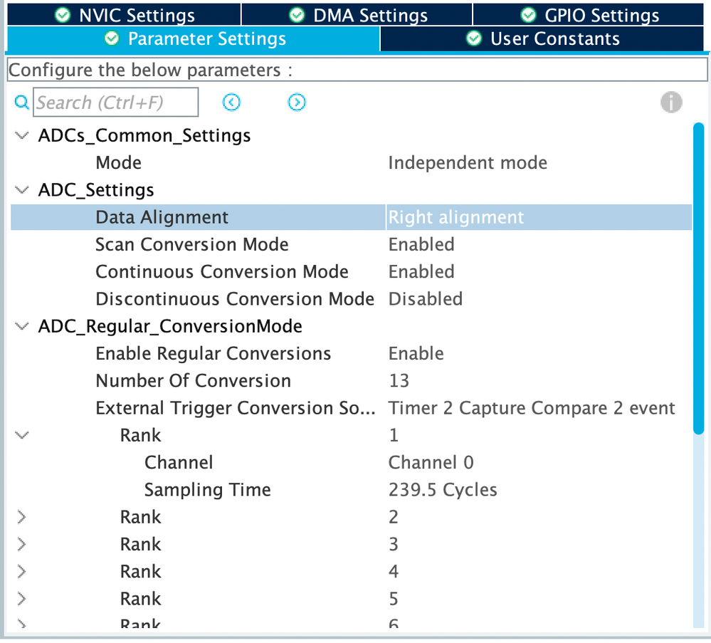

Bellow the CubeIDE settings and the automatically created code.

/** Common config
hadc1.Instance = ADC1;
hadc1.Init.ScanConvMode = ADC_SCAN_ENABLE;
hadc1.Init.ContinuousConvMode = ENABLE;
hadc1.Init.DiscontinuousConvMode = DISABLE;
hadc1.Init.ExternalTrigConv = ADC_EXTERNALTRIGCONV_T2_CC2;
hadc1.Init.DataAlign = ADC_DATAALIGN_RIGHT;
hadc1.Init.NbrOfConversion = 13;
if (HAL_ADC_Init(&hadc1) != HAL_OK)
Error_Handler();

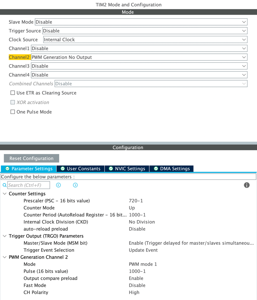

* @brief TIM2 Initialization Function
* @param None
* @retval None
static void MX_TIM2_Init(void)
/* USER CODE BEGIN TIM2_Init 0 */
/* USER CODE END TIM2_Init 0 */
TIM_ClockConfigTypeDef sClockSourceConfig = {0};
TIM_MasterConfigTypeDef sMasterConfig = {0};
TIM_OC_InitTypeDef sConfigOC = {0};
/* USER CODE BEGIN TIM2_Init 1 */
/* USER CODE END TIM2_Init 1 */
htim2.Instance = TIM2;
htim2.Init.Prescaler = 720-1;
htim2.Init.CounterMode = TIM_COUNTERMODE_UP;
htim2.Init.Period = 1000-1;
htim2.Init.ClockDivision = TIM_CLOCKDIVISION_DIV1;
htim2.Init.AutoReloadPreload = TIM_AUTORELOAD_PRELOAD_DISABLE;
if (HAL_TIM_Base_Init(&htim2) != HAL_OK)
Error_Handler();
sClockSourceConfig.ClockSource = TIM_CLOCKSOURCE_INTERNAL;
if (HAL_TIM_ConfigClockSource(&htim2, &sClockSourceConfig) != HAL_OK)
Error_Handler();
if (HAL_TIM_PWM_Init(&htim2) != HAL_OK)
Error_Handler();
sMasterConfig.MasterOutputTrigger = TIM_TRGO_UPDATE;
sMasterConfig.MasterSlaveMode = TIM_MASTERSLAVEMODE_ENABLE;
if (HAL_TIMEx_MasterConfigSynchronization(&htim2, &sMasterConfig) != HAL_OK)
Error_Handler();
sConfigOC.OCMode = TIM_OCMODE_PWM1;
sConfigOC.Pulse = 1000-1;
sConfigOC.OCPolarity = TIM_OCPOLARITY_HIGH;
sConfigOC.OCFastMode = TIM_OCFAST_DISABLE;
if (HAL_TIM_PWM_ConfigChannel(&htim2, &sConfigOC, TIM_CHANNEL_2) != HAL_OK)
Error_Handler();
/* USER CODE BEGIN TIM2_Init 2 */
/* USER CODE END TIM2_Init 2 */

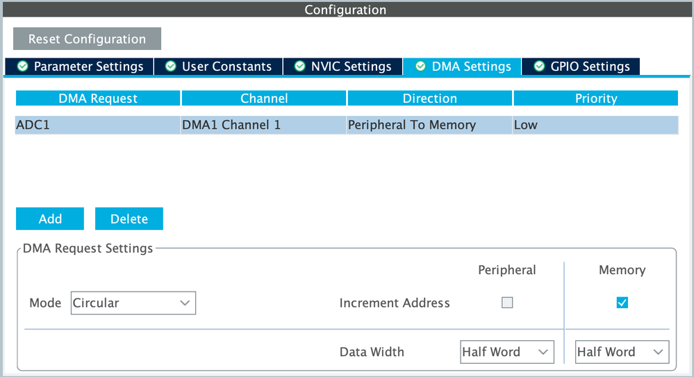

* Enable DMA controller clock
static void MX_DMA_Init(void)
/* DMA controller clock enable */
__HAL_RCC_DMA1_CLK_ENABLE();
/* DMA interrupt init */
/* DMA1_Channel1_IRQn interrupt configuration */
HAL_NVIC_SetPriority(DMA1_Channel1_IRQn, 0, 0);
HAL_NVIC_EnableIRQ(DMA1_Channel1_IRQn);
/* DMA1_Channel2_IRQn interrupt configuration */
HAL_NVIC_SetPriority(DMA1_Channel2_IRQn, 0, 0);
HAL_NVIC_EnableIRQ(DMA1_Channel2_IRQn);
/* DMA1_Channel3_IRQn interrupt configuration */
HAL_NVIC_SetPriority(DMA1_Channel3_IRQn, 0, 0);
HAL_NVIC_EnableIRQ(DMA1_Channel3_IRQn);
/* DMA1_Channel6_IRQn interrupt configuration */
HAL_NVIC_SetPriority(DMA1_Channel6_IRQn, 0, 0);
HAL_NVIC_EnableIRQ(DMA1_Channel6_IRQn);

‎2022-08-17 4:42 AM
It is a CubeIDE code generation bug!
The answer is to put
MX_DMA_Init();
before
MX_ADC1_Init();
As the first one calls
__HAL_RCC_DMAMUX1_CLK_ENABLE();
https://community.st.com/s/question/0D50X0000BbMcnpSQC/dma-adc-doesnt-work

‎2022-08-12 5:00 AM
What is your O/P ADCvalue? Can you share the picture of that
Make sure your ADC is getting triggered after the timer counter overflow.

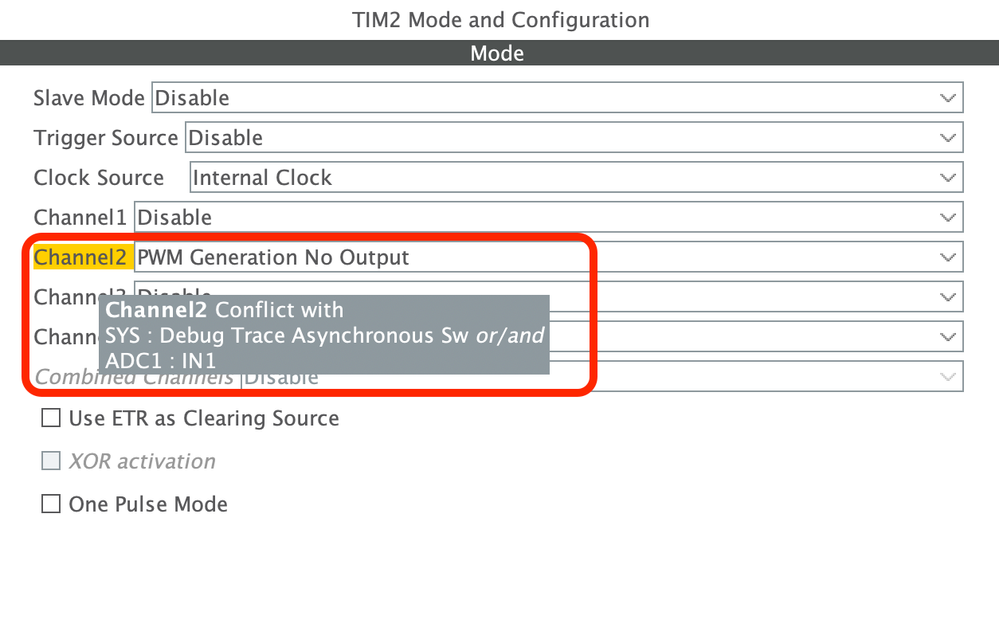

‎2022-08-12 8:11 AM
What do you mean with O/P ADC value? Reference voltage?
As I understand the ADC gets triggered when the CC (Capture Compare) value matches the timer counter. Which works.
I tried timer 3 out event as trigger source because I get this conflict warning for Timer 2 channel 2.But no difference. The conversion starts and I get the call back but only first value in the buffer.
