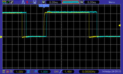

I'm working on a STM32F103V8. The TIM3 should decode the signal of a rotary decoder.
When I turn the rotary decoder clockwise the counter of TIM3 goes up.
When I turn the rotary decoder anticlockwise the counter of TIM3 goes up.

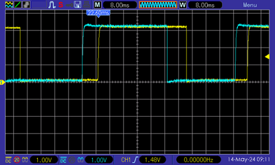

As @waclawek.jan suggested:
I observed the waveforms of the rotary decoder. (see images: clockwise/anticlockwise)
the waveform look as expected.

waclawek.jan
Observe waveforms on the two input pins using oscilloscope or logic analyzer. Or, read out and vizualize the GPIOx_IDR register, on which the two input pins are located.
Is the waveform as expected, i.e. with 90deg. phase shift in one direction and -90deg in other?
Aren't the inputs shorted?

DP_42

Inside the HAL_TIM_IC_CaptureCallback function i used a dynamic printf to read the inputs of the pins PA6 and PA7. Those are the signals TIM3 Ch1 & Ch2.
I saw that one singal was stuck to "1". This is the reason why the counter only counts in one direction.
I checked the wiring and found that the wiring was based on an old scematic. After fixing that the counter worked as expected.
