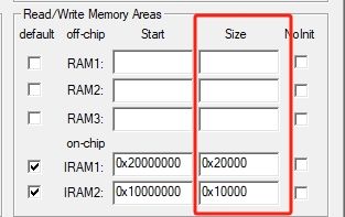

[RAM] STM32F103VCT6 has 48KB RAM , By modifying the upper limit in keil5, I was able to use 58k
Passerby
Why ? Why can I use more than 48KB RAM?
Thanks!

Hello @Passerby ,
how did you modified the upper limit of RAM in Keil?
I am using Keil5 too.

Options For Target -->Read/Write Memory Areas --> Size     , Change it to bigger
