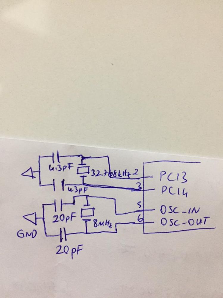

I also see Rext resistance in some designs. I don't know why they put it or how they put it (for exp. OSC_OUT in series or between OSC_IN and OSC_OUT).
Wouldn't it be enough if I put it this way?

Hi Bouraoui,
I made all my calculations following the AN2867 document.
  • You can see the calculations pictures for both LSE and HSE for CL1 and CL2.
  • I'm actually asking if Rext is needed. Because when I want to use Rext, Rext: 995 ohms according to my calculations. When I do my other calculations again, gmcirit = 5.51mA/V, gainmargin = 25/5.51 = 4.53 < 5 ( gmcirit(old) = 0.213mA/V, gainmargin(old) = 117 )
I had read in Section 3.4 that gainmargin should be greater than 5. Using Rext seems to be creating a problem, according to my design.
Would it be a problem if I don't use Rext? I am trying to understand this.
Regards,
Mehmet

Bouraoui Chemli
Hi @Mehmet Eyüp Arslan​ ,
As mentioned AN2867 Rev 12 Section 3.5.3; If the power dissipated in the crystal is higher than the value specified by the crystal manufacturer, the external resistor Rext becomes mandatory to avoid overdriving the crystal.
In your case, using Rext violate the gainmargin rule. I don't recommend you to add Rext.
Best regards,
Bouraoui
