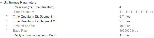

I'm trying to send CAN messages with the STM32F103C8T6 microcontroller (blue pill hardware with genuine ST chip) to a CAN analyzer without success.
I'm using STM32CubeIDE v1.12.0. I double checked the hardware, I'm using PB8 and PB9 pins to connect to the CAN transceiver (SN65HVD230 ) RX and TX pin respectively, I have 120 ohm resistor on both CAN line termination, I settled CAN baudrate to different baud but the result is always the same, no pin level changing on TX pin PB9, it remains always at 3.3V (looked with a scope meter), it seems that the CAN cell is not connected to the external pins. I'm not using the USB that is disabled, external 8 MHz crystal with PLL to have 72MHz clock. The code works because I have a LED that correctly toggle its status every 1 second, after a while the CANtransmit function HAL_CAN_AddTxMessage(..) return an error because it doesn't find a free trasmit mailbox. Attached the main function, please help
The value 1 is very small for BS1. Try to select a prescaler value as less as possible and BS1 and BS2 values as greater as possible with BS1 > BS2.
Example:

Did you try the Loopback mode before going to Normal mode? If not, I suggest to do it in order to, at least, validate the CAN cell.
APrim.2
Hi, I tested also the loopback mode, silent mode and loopback mode combined with silent mode and it is always the same, no message transmitted/received at all.
Example:
