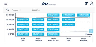

STM32F103C6T6 Flash Size is incorrect reporting 32 and not 64
bibble235
stm32cubeprogrammer v2.13.0 reporting incorrect size
As is st-info
Found 1 stlink programmers
version: V2J41S7
serial: 6600240013000039544B524E
flash: 32768 (pagesize: 1024)
sram: 10240
chipid: 0x0412
descr: F1 Low-density device
I am on ubuntu 23.04
Any help gratefully excepted.
STOne-32
Dear @bibble235 ,
that is correct. that part number is LQFP48 package with 32K of flash as show here in the STM32F103 lineup. May be you wanted the F103C8 ?
Hope it helps you ,
ciao  

My bad, wrong product page.
