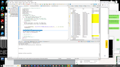

I have all 8 ADC down to GRND 0V I am using this command:
HAL_ADC_Start_DMA(&hadc1, AD_RES_BUFFER, 8);
The arry is:
volatile uint32_t AD_RES_BUFFER[19] = {0, 0, 0, 0, 0, 0, 0, 0, 0, 0, 0, 0, 0, 0, 0, 0, 0, 0, 0};
All 8 ADC returns between 752 & 759.

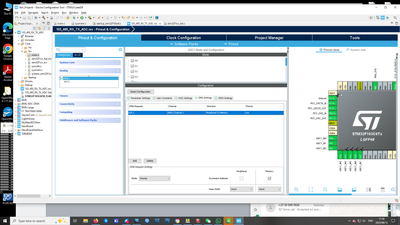

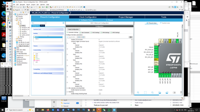

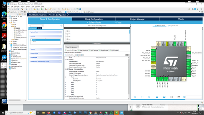

The ADC configuration is
This is the buffer from the IDE

You appear to convert the same channel over and over, or all channels are at the same voltage.
Read out and check/post the ADC registers content, especially the ADC_SQRx registers.
Do you perform calibration before the conversions, as per the reference manual?

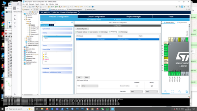

I removed the DMA settings compiled the code, put the DMA settings back compiled the code and now it is working:
