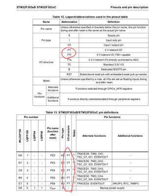

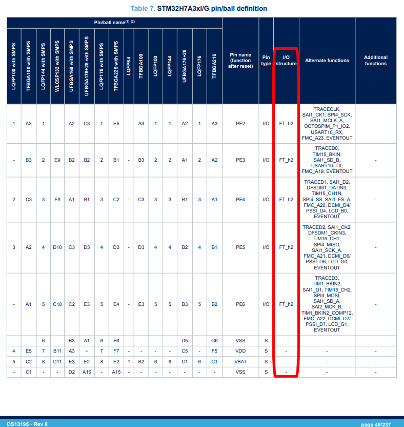

iam working on stm32h7a3zi controller in that datasheet they mentioned up to 164 I/O pins capable of 5V tolerant but they didn,t mentioned about which pins are capable of 5v tolerant

Reading datasheets is an essential skill. Here an example for another MCU variant:
As @Ozone said, Yes - they did:
