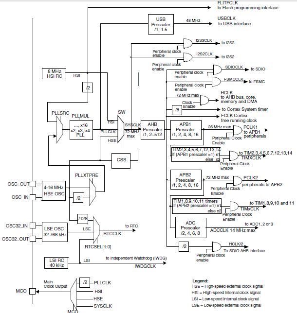

I have tried to set my MCU frequency to 36Mhz. However, on PA8 I see 72Mhz which is more than I wanted. I need to know what is my problem that the MCU frequency is not 36Mhz. In addition,when I use "RCC_DeInit(); " at the beginning of my clock configuration, I don't see anything at PA8.
it is necessary to change clock and make it safe (connected to HSI )when the external clock fails to 36Mhz (both mode should have the same frequency)

Hello
check the definition of "HSE_VALUE" if is different than your crystal (system_stm32f1xx.c)

‎2020-12-07 4:15 AM
hello, use RCC_PLLSource_HSE_Div2 as parameter to RCC_PLLConfig()

Thank you for your cooperation,
I changed it ,I just see a (8Mhz)semi-sinusoidal wave on PA8 instead of 36Mhz. but it doesn't work:

In addition, I need to know what the " RCC_MCOConfig(RCC_MCO_PLLCLK_Div2);" is. it means,will it produce the frequency after PLL multiplier? Because it returns 4Mhz in the output.
As I know, when the HSE and RCC_PLLSource_HSE_Div2 are selected the PLL frequency is 4Mhz (8Mhz crystal quartz) ( RCC_MCO_PLLCLK_Div2 should be 2Mhz or after PLL multiplier it shoud be (8/2=4Mhz as PLL input, 4*9=36Mhz , 36Mhz/2=18Mhz)

Hello
>RCC_MCOConfig(RCC_MCO_PLLCLK_Div2); is a seting on MCO multiplexer that selects the divided by 2, PLLCLCK freq as output to the MCO pin
>As I know, when the HSE and RCC_PLLSource_HSE_Div2 are selected the PLL frequency is 4Mhz (8Mhz crystal quartz) .. Yes it is true. This is the PLL input if selected as PLL source from PLLSRC multiplexer.
