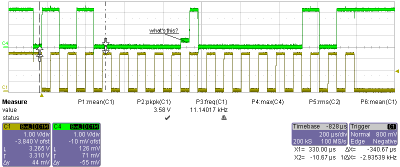

I'm using I2C1 on STM32F103 ARM to communicate with an I2C eeprom (24LC256). I can see both SCL and SDA on my scope but it seems there is a problem with the ACK at the ninth clock. I've made the same test with a lux sensor MAX44009 and i can't be able to see any ACK at all. The testing function i use is:void

I've attached also the signals from my scope. I've pulled up both SCL and SDA with 10k resistors (but i've tried also with 4k7 with no effect).

I've short circuited A0,A1,A2 to GND. In this manner the address is A0.
Instead of shifting the address i put the address already shifted...it could be the same, right? So i put A0 in the address without shifting. I've tried also to shift the address..but in that case i dont's see activity at all. If i use the address without shifting i see the waveform showed in figure. I've to use I2C. I've tried many times with different code, so i've tried also to use it in SMbus..but the behaviour is the same. I've forgotten to replace I2C in the code attacched here. What i don't understand is the shape of the signal on the ninth clock (as you can see from the image attached). It seems the slave is trying to answer.- Mark as New

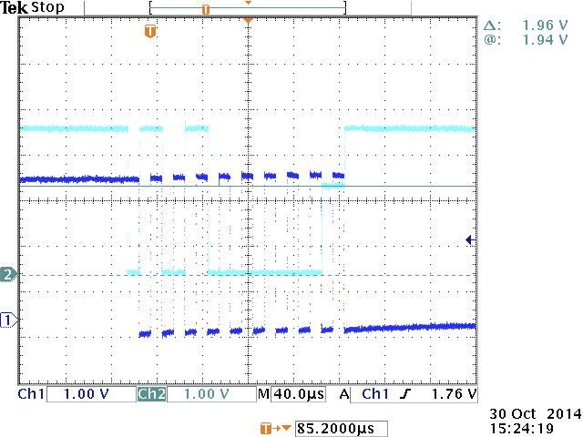

I've also problems with the I2C-bus. I tested with the original dirvers of ST on the mcbstm32f400 eval kit of Keil. Also tried it on our pcb with a stm32f427 micro. We see the seem problem. At the 9de bit after the address, eeprom has to give an ack. But we get an ''half'' signal. The ST micro tried to pull-up and the eeprom to pull-down. When I tested it with ''handclocking'' in the code, it's okay. That means that the bus and address is correct. When i put an strange address for the eeprom, you see that the ack is 100% high. Thats okay, becauce there is no ic with that address. It looks like that the micro don't expect an ack. But bit 10 of CR1 is high, the reg-settings: I2C startup REG CR1 0x0401 CR2 0x002a CCR 0x01a4 TRISE 0x002b OAR1 0x4001 ** ST1 0x0000 ST2 0x0000- Mark as New

The microcontroller I2C pins SDA and SCL must be configured as open-drain. Your oscillogram looks like SDA is configured as push-pull (or your pull up resistor value is much too low - typically between 2k2 and 10k).
‎2014-10-31 1:52 AM
-The pull-up resistor is 2k2
-I set the portmode to 2 (alternate mode) -outputtype to 1 (opendrain) -pullup/pulldown to 2 and also tried 0 (2==pulldown // 0==no_pp) -set AFR to 4 (I2C1)
