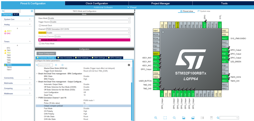

STM32F100RBT6 TIM15_CH1 and TIM15_CH1N complementary pwm mode does not generate the complementary output
‎2020-08-15 11:40 PM
I have a problem with my complementary output generation at Timer 15 Channel 1. I have set all parameters at CubeMX and have set
HAL_TIM_PWM_Start(&htim15,TIM_CHANNEL_1);
HAL_TIMEx_PWMN_Start(&htim15,TIM_CHANNEL_1);
inside USER CODE BEGIN 2.
The output for PB14 (TIM15_CH1) works very well but PB15 (TIM15_CH1N) is always set to 0 and nothing actually takes place. I don't know what is wrong since I have set all parameters the way I always do when dealing with for instance TIM1 for complementary output.
Below there is an image with further details regarding the pins and features I am using in the microcontroller.
Thank you in advance.

‎2020-11-02 2:09 AM
Yes, my point was merely that it seems to be an old problem with the MX Cube, still existing problem
‎2020-11-02 2:13 AM
Ah I see.
