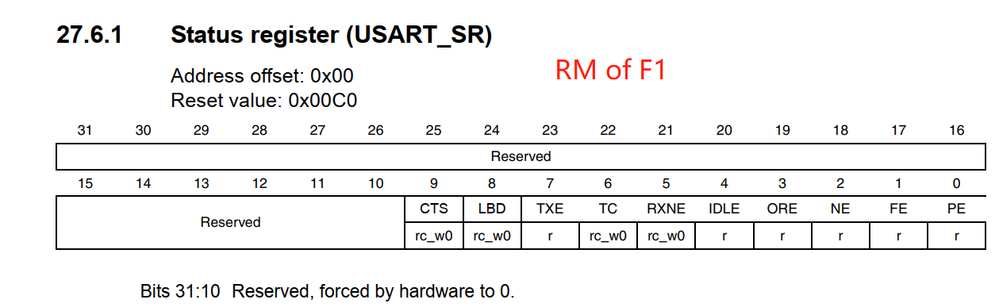

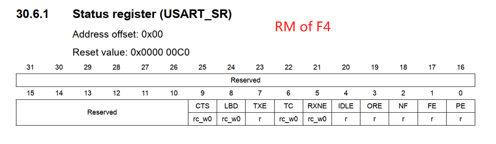

stm32f1 f4 usart sr register reset value are different,it is print error or it is truely different

0x00C0 and 0x000000C0 are the same values. The space is there only to visually separate the many digits in a 32-bit number (I personally prefer 0x0000'00C0, but there's no universally accepted "standard" for this).
