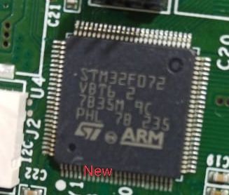

We have facing issue on microntroller we have recieve we have serial product and curretly we are using STM32F072VBT6 controller but we have order new lot and we are recieve STM32F072VBT6 2 and both are behaviour diffrent so what is major diffrence between them ? please suggest me.

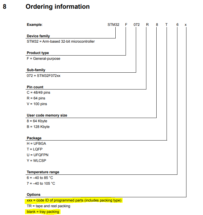

As already mentioned in the datasheet DS9826 and precisely section 8. ordering information, this marking indicates the options as shown in the below figure.
_legacyfs_online_stmicro_images_0693W00000biEKpQAM.pngWhen your question is answered, please close this topic by choosing Select as Best. This will help other users find that answer faster.

See Both the controller New and old currently we are facing problem on one GPIO with same software and we dont know how many another GPIO problems.Please suggest me what we can do.

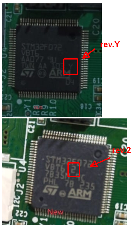

This is the chip revision
Check errata to find out if there's any relevant difference between the revisions - most likely, there is none.

I'm sure there's documentation, these parts have different die from different fabs.

The software should be able to identify which part is which, they have different die, and will identify differently in a register you can read.
https://www.st.com/resource/en/reference_manual/rm0091-stm32f0x1stm32f0x2stm32f0x8-advanced-armbased-32bit-mcus-stmicroelectronics.pdf
DBGMCU_IDCODE Address: 0x40015800

Could you please check the REV_ID of STM32F072VbT6 2 using STM32CubeProgrammer.
What is the REV_ID you have found?
