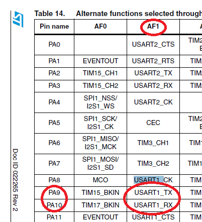

Hi, I'm switching from a stm32f100 to the stm32f051, most of the code is working already. but the usart1 does not work. The output doesn't change when I am trying to send something.

Can anyone tell me, if there is a problem with the initalization? Thank you for every help. #stm32f051-usart-usart1

For USART1, this should be workable

GPIO_PinAFConfig(GPIOA, GPIO_PinSource9, GPIO_AF_1);
GPIO_PinAFConfig(GPIOA, GPIO_PinSource10, GPIO_AF_1);

Posted on February 25, 2013 at 18:47
thomasganahl9
Posted on February 26, 2013 at 09:18
Thank you very much.
Now it works - there was just the failure with the alternative function table.
