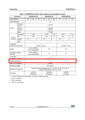

I am trying to configure the internal cooperators in the STM32F051 micro-controller, but in the .ioc file I am able to configure only one Comparator. I require three comparators for my application. Is it possible to configure multiple comparators on the STM32F051 development board? If so, could someone please explain how to configure multiple comparators in the STM32F051 micro-controller?

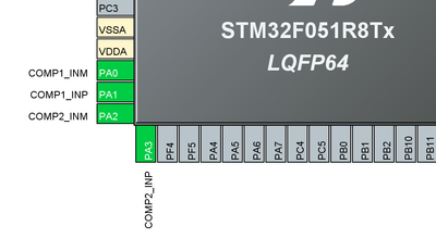

Only one ST board that uses this chip and comparators 1 and 2 are easily configurable in CubeMX with it.
Attach your IOC file. Perhaps the pins are already being used by other peripherals.

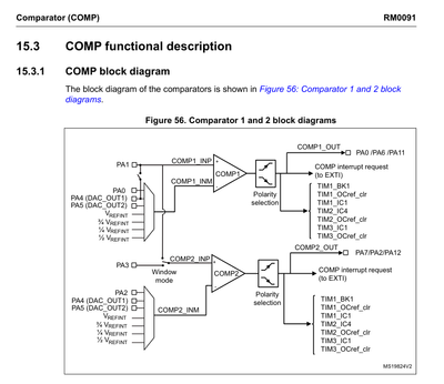

PA1, PA2, and PA3 are the positive input pins of Comparator 1, and PA0, PA4, and PA5 are the negative input pins of Comparator 1. Can I configure these pins simultaneously and use Comparator 1 as a multiplexer?
can I configure comparator 1 as MUX?
I've had a look at the 'F0 and it does not have that flexibility.
Only PA1 can be used as positive input to COMP1. You can multiplex between PA0, PA4 (you must not enable DAC) and PA5 as negative inputs to COMP1. (And yes, those pins can be all set to Analog at startup, and then selected by controlling the MUX in COMP_CSR.COMP1INSEL field).
Similarly, PA3 is the only positive input to COMP2.
So you don't have three pairs of pins which could be used even with multiplexing.
This is the lowest range of STM32; there are families with more comparators (e.g. 'F3).

I am trying to configure PA1 as the positive input and PA0, PA4, and PA5 as negative inputs. However, in STM32CubeMX, I am only able to configure one pin as the negative input. Why is this happening?
waclawek.jan
CubeMX - as any configurator and the associated libraries such as Cube/HAL - inevitably implements only "typical" settings - writing tools  and libraries which would cover all the possibilities these microcontrollers offer would take too much time and cost too much money. I don't use CubeMX, I program directly through registers, in that way I am free to set them up in any way they allow.
Generally, you should set all four pins as Analog in GPIO_MODER - I believe CubeMX may allow that for the remaining two pins - and then you select whichever negative input you need, in runtime.
