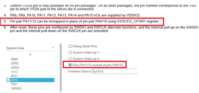

Using STM32CubeIDE (v1.14.0) with STM32F042F6P7 (TSSOP 20) to configure CAN pins on custom board. However the CAN peripheral is grayed-out when I open the IOC file in STM32CubeIDE. For pin assignments, PB8 is available for CAN rx but CAN tx is not show for any other pin. How do I access alternate pins for the CAN peripheral? Reference manual says PA12 should be available as alternate for CAN tx; and PA11 should be available as alternate for CAN rx.

As stated in the datasheet you need to remap the IOs PA11/12 in place of IO pair PA9/10 using SYSCFG_CFGR1 register:
So in CubeMx go to SYS menu and check the checkbox "Pins PA11/12 instead of pins PA9/10". CAN peripheral will be available.

I was able to select alternate functions for pins on another STM32 part using <Ctrl + mouse left> when configuring pinout in IOC file. This doesn't appear to be possible with the STM32F042F6P7. Does this mean I can't use the STM32CubeIDE and HAL for the STM32F042F6P7 part?
mƎALLEm
