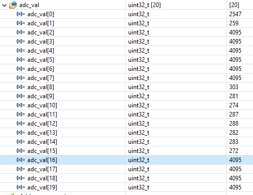

I am trying to get the ADCs operational on my board that uses an STM32F030C8 processor.
PA0 pin analog seems to read OK ~2200 which is approx OK.
Reading CH16 and CH17 (Temp sensor, VrefINT) always return a value of 4095.
Main()
we call the Init
MX_ADC_Init();
Inside the Main  While loop I tried reading all ADC channels
while(1)
		for(uint16_t i=0; i<20; i++)
			ADC1->CHSELR = ADC_CHSELR_CHANNEL(i);
			HAL_ADC_Start(&hadc); // start the adc
			uint16_t tmp =HAL_ADC_PollForConversion(&hadc, 100);
			adc_val[i] = HAL_ADC_GetValue(&hadc); // get the adc value
			HAL_ADC_Stop(&hadc); // stop adc
			HAL_Delay (500); // wait for 500ms

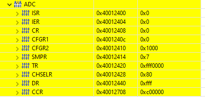

The ADC register look Ok (to me, but im sure im missing something).
The return values from main are like this
I would appreciate any pointers any one has here because Ive been looking over this for the past week without to much success.
