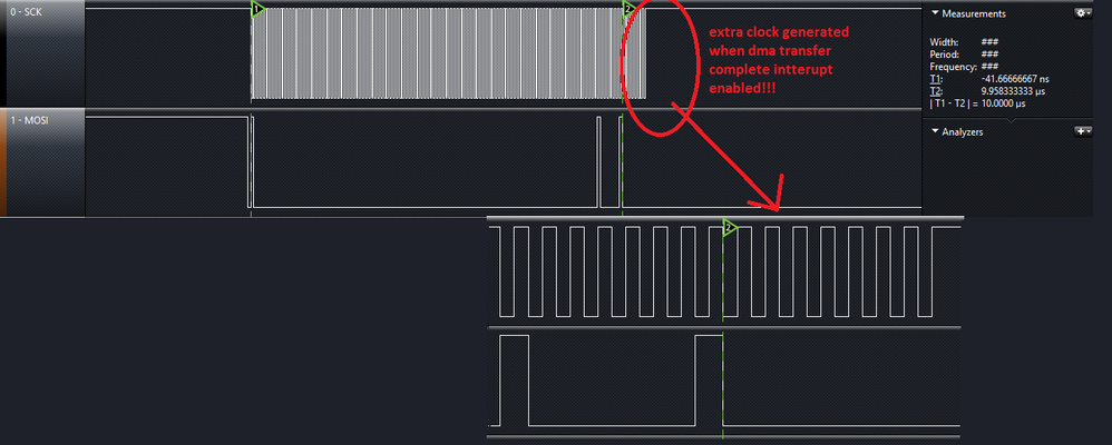

Hi
i wrote sample code to transfer data by spi and use dma
i test my code in 3 step
when dma transfer complete interrupt disable, when dma half transfer interrupt enable, and without interrupt
this is my code ,just i comment interrupt cmd function for test result:

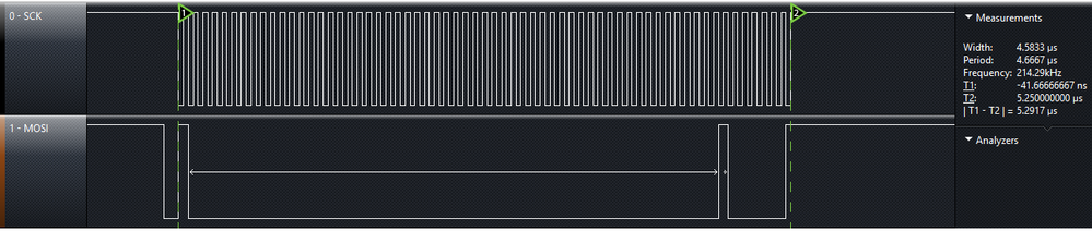

first test without enable any dma interrupts:
you can see result is ok and data correct transfer.
test 2,enable only transfer complete interrupt!:

and result is:
and you can some extraaaa invalid clock generatee end of data transferedd!!

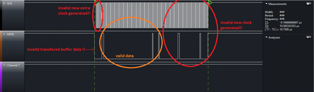

and finaly when half transfer and complete transfer enable i got severaaal extra clock!
following by this code:

in above code i enable transfer complete interrupt & half transfer data interrupt and i got this result
whats problem????
what's m mistake???
thnx

Hi!
That could be a feature of SPI bus on F030 series, even others families.
Firstly, you'd better cast DR register in SPI, if you use 8-bit width bus.
Secondly, it's quit good to wait until read DR register.
/* Send command and skip dummy byte */
*(__IO uint8_t*)&SPI1->DR = cmd;
while (!(READ_BIT(SPI1->SR, SPI_SR_TXE)));
while (!(READ_BIT(SPI1->SR, SPI_SR_RXNE)));
SPI1->DR;
Whereas using DMA, you should wait while transfer is complete.
uint8_t pump = 0;
/* Enable DMA transfer */
SET_BIT(SPI1->CR2, (SPI_CR2_TXDMAEN | SPI_CR2_RXDMAEN));
CLEAR_BIT(DMA1_Channel3->CCR, DMA_CCR_MINC);
DMA1_Channel3->CMAR = (uint32_t)&pump;
DMA1_Channel2->CNDTR = cnt;
DMA1_Channel3->CNDTR = cnt;
SET_BIT(DMA1_Channel2->CCR, DMA_CCR_EN);
SET_BIT(DMA1_Channel3->CCR, DMA_CCR_EN);
/* wait DMA complete transfer and clear correspondent flag */
while (!(READ_BIT(DMA1->ISR, DMA_ISR_TCIF3)));
SET_BIT(DMA1->IFCR, DMA_IFCR_CTCIF3);
/* wait SPI to release */
while (READ_BIT(SPI1->SR, SPI_SR_BSY));
/* Disable DMA transfer */
CLEAR_BIT(SPI1->CR2, (SPI_CR2_TXDMAEN | SPI_CR2_RXDMAEN));
CLEAR_BIT(DMA1_Channel2->CCR, DMA_CCR_EN);
CLEAR_BIT(DMA1_Channel3->CCR, DMA_CCR_EN);
