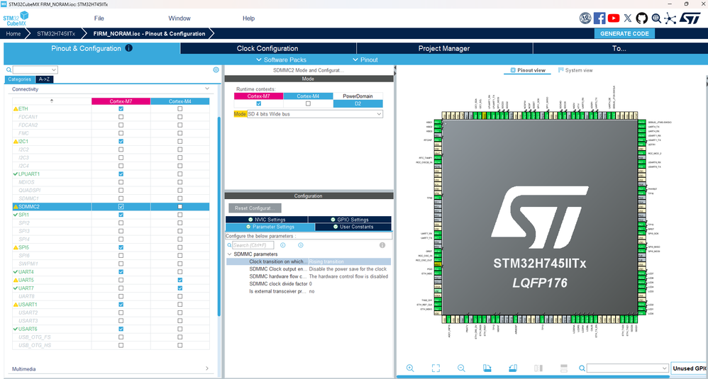

Initially I set mode: SD 4 bits Wide bus and configuration is:SD.png
NVIC: Enabled
NO constants
GPIO Setting:
- PB3: D2, PB4: D3, PB14: D0, PB15: D1, PD6: CK and PD7: CMD
- DMA: not exist??

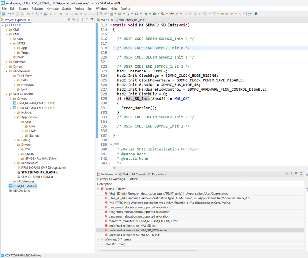

Only with this code is the following error generated in CubeIDE:
(HAL_SD_Init): Unknown destination type (ARM/Thumb) in ./Application/User/Core/main.o
(HAL_SD_IRQHandler): Unknown destination type (ARM/Thumb) in ./Application/User/Core/
undefined reference to `HAL_SD_Init'
undefined reference to `HAL_SD_IRQHandler'

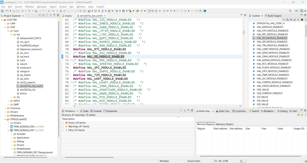

Is the macro #define HAL_SD_MODULE_ENABLED is defined in stm32h7xx_hal_conf.h. If this define is missing, the SD HAL APIs such as HAL_SD_Init() and HAL_SD_IRQHandler() may not be compiled correctly.

Are those the only errors ?
Specifically, are you also getting dangerous relocation: unsupported relocation errors ?
If so, see this thread.
