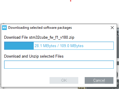

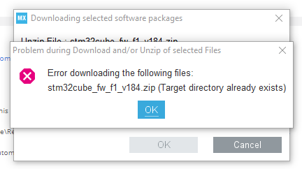

I am running into a problem with updating the STM32F4 library in STM32CubeMX ver 4.19. I want to install the STM32F4 library package ver 4.14. However, I get an error stating 'These Files have problem during Download : stm32cube_fw_f4_v1140.zip (Target directory already exists)'
I am able to install the previous STM32F4 package, rev 1.13 without problems.
I have tried uninstalling, reinstalling, deleting the repository package directory, etc, etc. No dice. Perhaps I am missing a directory to clean up while reinstalling. Also, I can see where the .zip is downloaded to when running the updater. There is nothing there. It shouldn't have any problems. I also tried installing the package via the 'Load from file', but no dice there. I get an error that way too.

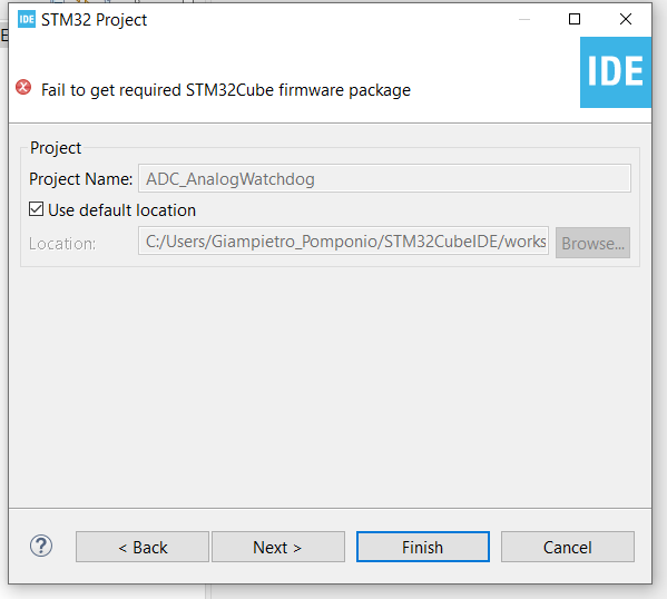

Hello all,
I've the same problem. I'm working with:
I've installed the last MCU Package for the STM32WB:
But when I try to import an example, I've the following error:
I've followed all previous suggest without resolve problem. How can I resolve this issue?

Hello all,

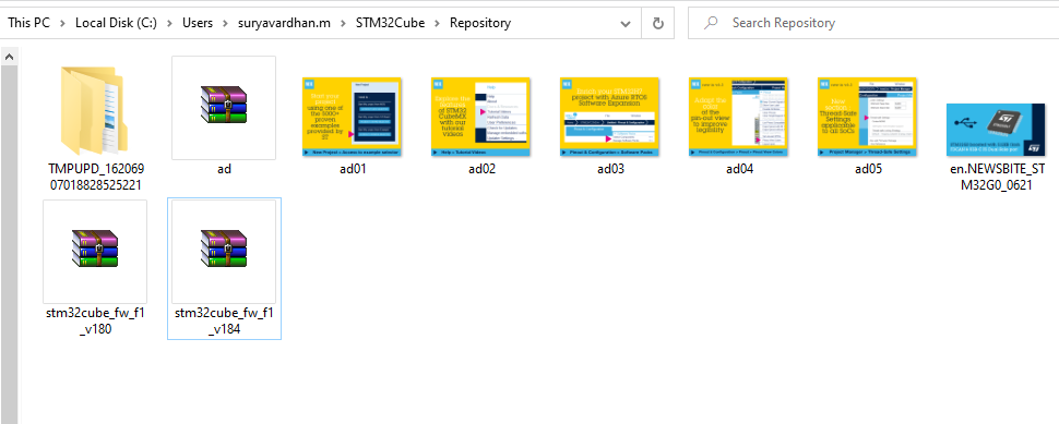

- ST CUBE IDE /MX has different zip files for Firmware Package Name and Version,
- While downloading selected software packages and unzipping it, Cube IDE & MX tries to unzip its contents into the same folder name. [In my case it is stm32cube_fw_f1_v180 & stm32cube_fw_f1_v184 ]
- As the IDE is not able to over write the zipped contents into the same Folder, it throws the error and Project Creation gets aborted at this stage.
- Now check the repository folder location and you should find the ZIP files downloaded by STM32 CUBE IDE /MX.

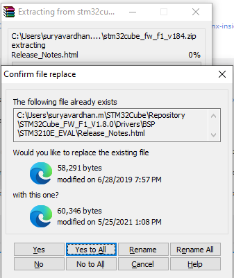

- All you have to do is "unzip the files one after the other in ascending order of firmware version", select the option "Extract here" .
- Do the same for all the downloaded Firmware Packages and select "Yes to All " when prompter to conform to replace the existing file.
- Once its all extracted, delete the old project and start creating an new project and it would not give any trouble.
