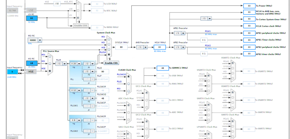

Ido not know if this is also connected with 1.9.0 or it is a known issue (samePLLSAI1 clk config, but with additional peripherals, on 1.6.0 works).I am using custom board with STM32L476 on it.
I use CubeMX to generate code, i only set SD, JTAG, and RCC peripherals Clock config as shown on provided image:
Generated project (without changing anything in it) successfully builds, but itfails in file
''stm32l4xx_hal_rcc_ex.c'' line 2948(using 1.9.0 package)

(it eventually evaluatesto ''[7]+1 !=1'').

quick updates, if in future somebody gets to similar problem.
There is a missing line in system clock config*
PeriphClkInit.PLLSAI1.PLLSAI1M = 1;
Second issue was not setting 'SDMMCCLK divider factor' in 'Configuration->SDMMC1' window.
I set it to 250 so i am under 200KHz (i didn'texperiment with other values), for beginning of communication with eMMC card. This seems tobe OK for my configuration. Adapt as need for your PLL config. I will try higher freqs when my eMMC driver will be stable.
