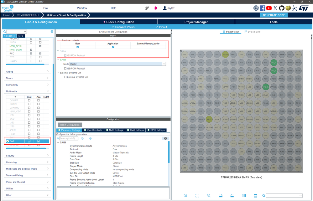

I am currently working on STM32H7S3 family. I want to set up SAI2 peripherals on CubeMX application. But, SAI2 can be enabled from multimedia, only SAI2B can be activated. SAI2A cannot be enabled from the Mode and Configuration screen. You can find the CubeMX screen shots below.

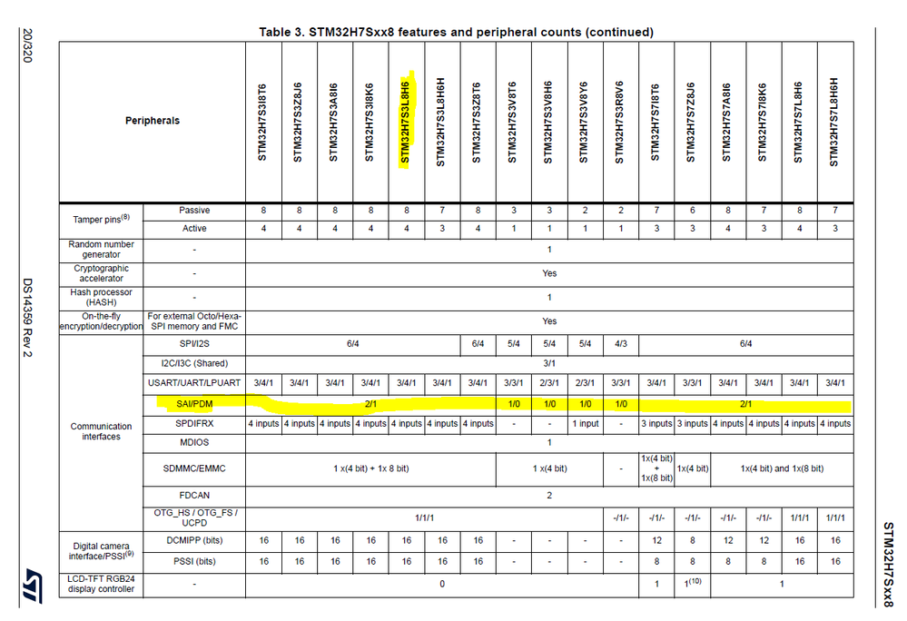

In data sheet there is no problem with SAI2A interface.
Is there any problem about my configuration or CubeMX?
Thanks in advance
Yavuz

Hello @YavuzKagan
Thank you so much for reporting this. I've been able to reproduce it on my side and I've reported this to the concerned team for correction on the next releases (under internal ticket number 187843).
Best Regards.
