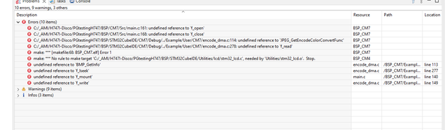

Ive already made sure to include the paths in the includes section under the paths and symbols section.
this is the error I'm getting:
I was also trying to change the includs order of all the relevant files so that the USE_JPEG_ENCODER was defined before the jpeg_utils.h itself so that the jpeg_utils.c will have everything it needs while compilng
the complier finds the files but the JPEG_InitColorTables() function itself is still "locked"
Show the full contents of the Console tab after you try to clean and rebuild.
Apparently the "clean and rebuild" did the trick, I'll continue to try and "play" with everything a bit more and continue to update here if I have more issues
thank you very much!
I think the 'Undefined Reference' is a Linker error - not a compiler error.
So this wasn't a problem with include paths/files.
As @TDK suggested, the Console output is a lot more informative that this "Problems" list

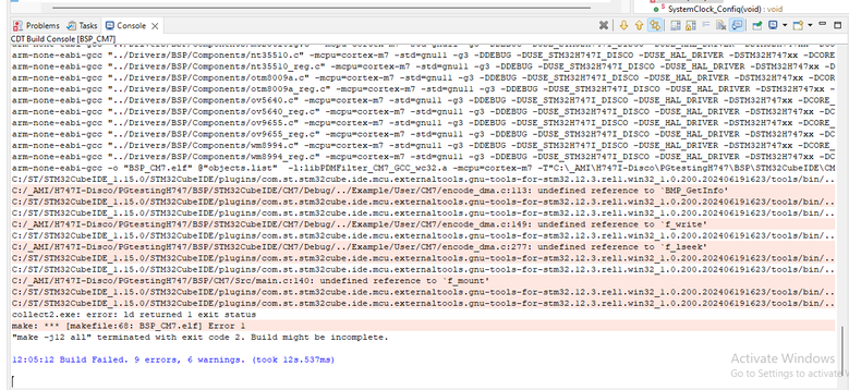

ok so I tried adding FATFS functions, but the compiler didn't recognize them,
Is there a way to activate it without an IOC file?
Is there a way to activate [FatFs] without an IOC file?
Of course there is - it's just 3rd-party open-source code:  http://elm-chan.org/fsw/ff/
If you post the full output log as I requested above, I will look at it.
I can't help you if you don't participate. It is tiresome to reply to "X didn't work" posts without supporting information.
here's the current Console Status:
Here is the Problems tab for the full context:
Is there anything else I can add?
