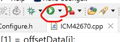

But when I press "Run" button on the top panel, no hardfault.
