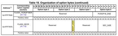

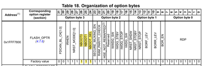

Well, let's look at the default values for the option bytes, which is found in the reference manual.
Okay, so we know NBOOT0_SEL = NBOOT0 = NBOOT1 = 1 (ignore the small typo) and BOOT_LOCK = 0.
Let's now look at AN2606 table to see where that puts us.
Since NBOOT0_SEL = 1, the state of the BOOT0 pin doesn't matter. Here are the ways to get into the bootloader:
The only way possible with default option bytes is if the main flash is empty. So do that using STM32CubeProgrammer, or change the option bytes so BOOT0 high can enter the bootloader.

Now it works: The BOOT_LOCK option bit was set to 1. With BOOT_LOCK set to 0 and nBOOT0_SEL set to 0 it works well.
