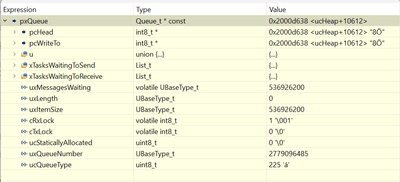

Hi all
I'm pretty sure this was already a topic, but i haven't found a solution yet. Since i'm a beginner i definitely need some help here.
I'm sending UDP data with LWIP and FreeRTOS. It works, but after some (random) time the code gets stuck at
configASSERT( pxQueue->uxItemSize == 0 );
I tried some settings but nothing helps. It is stopping even if I do not send data .
Any ideas?
Cheers

A stack overflow might cause this kind of internal data corruption. Did you enable stack checking ? See https://www.freertos.org/Stacks-and-stack-overflow-checking.html

This might be a buffer overrun resulting in the memory at pxQueue being stomped.  I'd suggest looking at what's in memory prior to pxQueue for clues.

@David Littell : "I'd suggest looking at what's in memory prior to pxQueue for clues". Does this help somehow:
Stack size for the taks is, if I'm correct 256 (words).
Cheers
David Littell
Senior II
December 14, 2023
It does look like the queue structure in memory is being stomped by something.  As a quick test you could try 4x all the stacks.  You can also convert the uxMessagesWaiting value to hex and see if that's a memory address you can examine.
