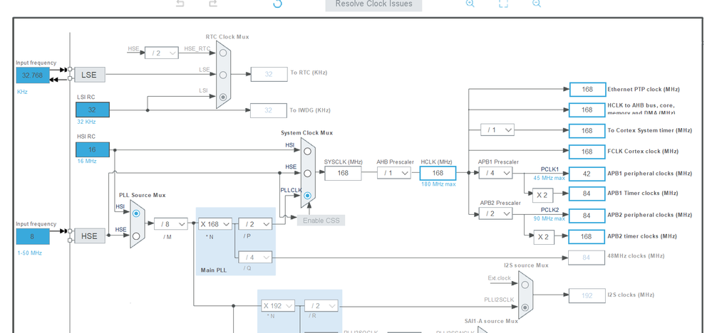

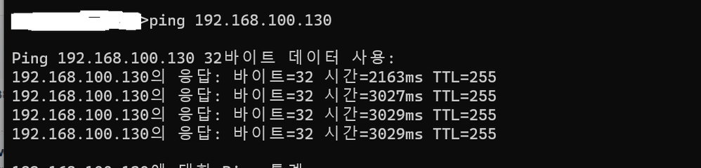

I am developing a device using the nucleo-f429zit6 evaluation board as a reference. This device has an Ethernet communication function, and the Ethernet communication function was tested by directly connecting this device to the server using a cross-Ethernet cable. Currently, after a command is delivered to the device from the server, the response from the device arrives at the server late. As an example, I checked the server's response to a ping command, and the initial response took about 2 seconds. I'd like to know how to improve this response so that it comes out quickly, within 1 second.
The current device's slow Ethernet communication response speed
Below is the clock speed of the hardware used by the device, the firmware version currently being used, and the version of LwIP.

I haven't found a solution yet. stm32f429zit6 is being used in the device under development, and the clock frequency used is 168 MHz. Which MCU do you use and what is the frequency?

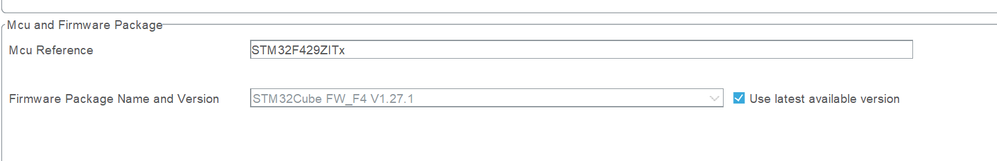

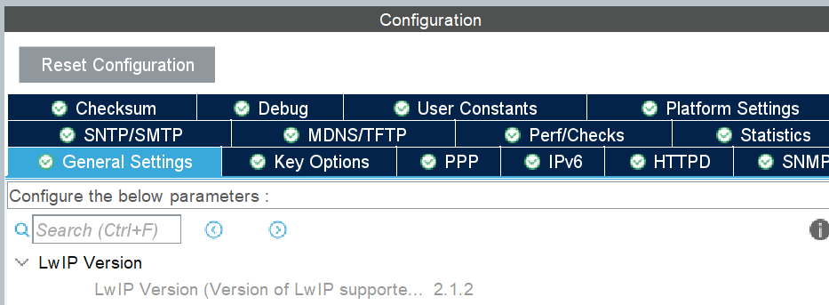

Below are the CubeF4 and CubeMX versions and the LwIP API type in use.
Cube F4: 1.27.1
CubeMX: 6.9.1
LwIP: 2.1.2
LwIP API in use: Raw API
Due to the nature of the project, it is difficult to share the entire ioc file with the community. I am currently creating an ioc file in STM32CubeIDE, and if there is a part that needs to be reviewed, I can capture that part and share it.

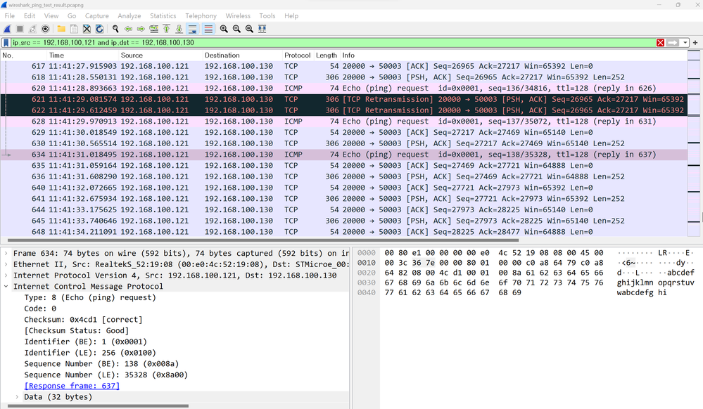

The ping command is used to measure the Ethernet response time of the device. Wireshark is used to share Ethernet transmission and reception communication packets between the server and device. The packet data also contains the results of sending a ping command from the server and responding from the device.
In the wireshark log above, the server's IP address is 192.168.100.121 and the device's IP address is 192.168.100.130.

I don't know how @Piranha knows your code is only expecting 1 packet per IRQ - perhaps from your earlier posts, or he just knows that is how the "new" ST Ethernet code is written (I don't use the new ST Ethernet code).  But he might be right - or on the right track.  I see NO packets FROM .130 in that wireshark log file.  no ICMP responses and no TCP packets.  So either you have wireshark filtering and only display/capturing packets from .121 or something is seriously messed up somewhere.
If Pirhana is right, his mention of "your code" is really "the ST Ethernet driver used in your code" (i.e. code ST provided, not something you wrote).

For Wireshark just use a filter "host 192.168.100.130" and it will filter out everything related to that IP address.
