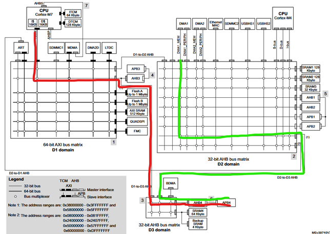

I've done a bit of high speed stuff with STM32. Admittedly nothing like this, but with timers triggering DMA that writes to a GPIO to generate a complex waveform (IRIG-B) it was pretty fast, maybe 40ns maximum latency with a 100MHz clock. I didn't dive too deep into it, it's possible that it's occasionally worse than that if one of the internal buses is busy.
Somewhere there is a thread looking at the maximum GPIO toggle rate using CPU instructions. For the H7, I think it's something like 8 MHz, despite the CPU being 400ish MHz.
It's not that the GPIO is slow, it's the busses needed to get from the CPU to the GPIO that take time. The path from DMA to GPIO may be quicker.
This is a dual core H7. Other chips are considerably different.

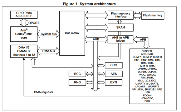

This is the G0 which has DMAMUX and the necessary triggers but the DMA doesn't have access to GPIOs so it won't work at all for you, I believe.
