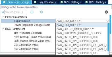

I have designed a PCB with 3 STM32H725VGT6 MCUs, and assembled them according to my schematic:
(sorry for this resolution, this is from a converted pdf)
All 3 MCUs are the same, from this schematic.
R5 and R2 are just 0R jumpers to select the boot mode.
At first, ST-Link couldn't find any of them.  When I checked the voltage on the Vcap pin the MCU1 had 1.0008 V at both 2.2uF caps. STLINK still can't find the target. MCU2 and MCU3 had 0.0000V. on the Vcap pins.

Best answer by fing
Update:
After some investigation, I found that the main source of the problem was actually caused by incorrect settings in the .ioc file.
These are the correct settings for LDO operation.
I can only upload these incorrect settings once. After that, the MCU spits out 0 V on the Vcap pin and it is basically bricked. I have read that if you manually inject 1.3 - 1.4 V on a Vcap pin, you can bring it back to life.
But this was not necessary for my case, because I was able to desolder my BOOT0 jumper and pull it high. Now, ST-Link can detect the MCU, upload and verify the code.
The current consumption went up a little, which meant that the MCU was up and running with 550 MHz.

Yes, it actually follows the LDO operation, where VDDLDO = VDD. They are powered externally with a power supply giving 3.3 V.

Update:
