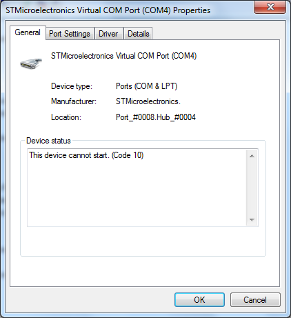

greg_t
Posted on May 17, 2011 at 14:26
when connecting my board to PC with winXP the usb is recognized but when connected to win7 the usb is not recognized
Clifford1
I have experienced problems with Windows 7 x64 using the x64 version of the driver.  Device Manager shows the device, but no connection can be made.
[edit]Further testing on Windows 7 32bit reveals the same problem. See Device Manager screen-shot below.  The target remains permanently stuck in the USB interrupt context.  The target in this case is an STM32F105VC (connectivity line)
Clifford1
I appear to have fixed this issue, it was a problem with the target device implementation not the driver.
My implementation modifies the rather basic example VCP code to make it more general, to have the same API as my USAT driver, and to integrate it with Keil RTX RTOS kernel.  Getting that right was key to the port being correctly recognised it seems; though it was working on XP.
It is a shame that the example code is so specialised and poorly documented that adapting it for one's own needs risks breaking it.
