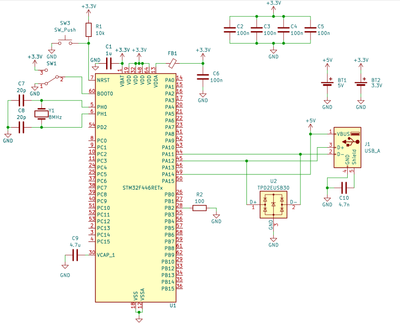

I would like to program an STM32F446RET MCU with USB DFU bootloader. I did the following connections:
- board VCC to USB cable and VBUS_FS
- board GND to USB cable
- UDB_DP to USB cable
- USB_DN to USB cable
When reset BOOT0=3.3V and BOOT1=GND
The MCU seems to enter in the bootloader (the main program does not start) but STM32Programmer is not able to connect to the USB device
Am I missing something?
EDIT 1: This is a circuit that is very close to the one I used
EDIT 2
I discovered the source of the problem, but not the solution. Here's more details. There is a USB A receptacle on the board and:
  • if I use a USB-A to USB-A cable to connect the board to the PC everything works.
  • if I use a USB-A to USB-C cable to connect the board to the PC it does not work.
  • if I use two cable adapters: USB-A to USB-A (male) and USB-A (female) to USB C, it works
It seems like that when USB C is used we need an additional circuit (the same that it is inside the cable adapter). Which circuit? I'm not able to find anything on the internet

Is this a custom board? If so, is a schematic available?
Can you program it using the SWD connections?
I'm hoping you're converting the 5V to 3.3V with an LDO before connecting it to board VCC, right?
DamianoF
Thanks for the help!
Yes, this is a custom board. And I am able to program it with SWD.
I edited the question to add a simplified schematic of the whole circuit.
The board is not powered through USB but has another power source which provide both 5V (which is connected to USB and VBUS_FS) and 3.3 V (to power the MCU).
