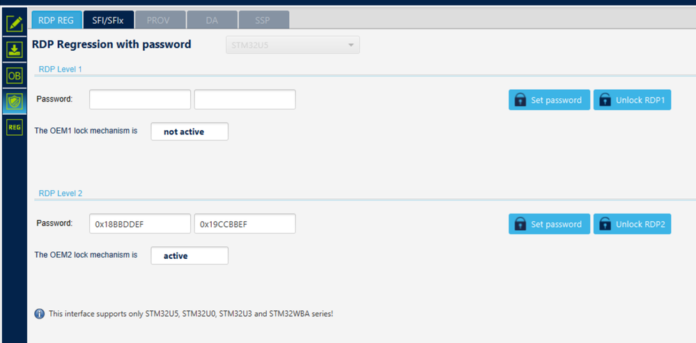

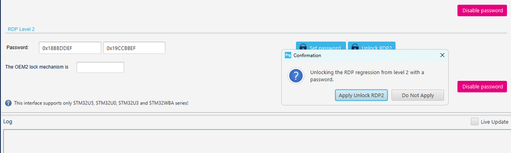

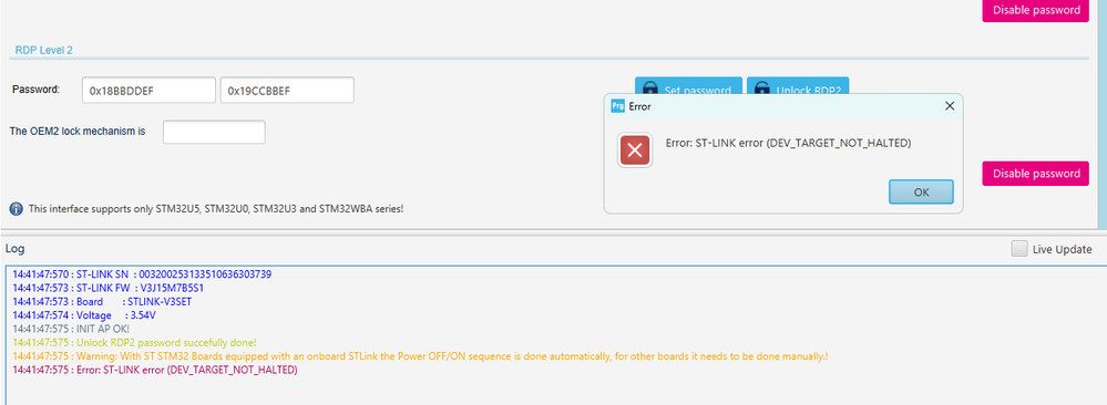

2. I have attached the steps we followed - it appears that RDP Level 2 is being unlocked, but afterward we are encountering a DEV_TARGET_NOT_HALTED.
Could someone please review the steps and helps us resolve the issue?
Hi @Gaurangthaker ,
the error message say that the debug interface cannot connect to the CPU because it's not halted (running). Did you try reseting or power cycling the u5 after unlocking?

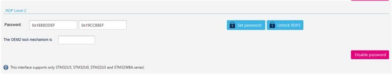

I also find it strange that your screenshot is not consistent with the 2.19 and it's not showing that the OEM lock is active. Did you establish the connection to the device prior to unlock attempt?

I tested the whole process and it works fine, you just need to cold boot the MCU after unlocking to force OBL.
