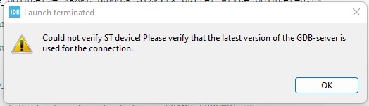

I am trying to debug my Nucleo H723ZG board using the CN5 (MIPI10) and a Segger J-Link Pro. But I have tried both methods described in the UM2407 6.3.3 "Using an external debug tool to program and debug the on-boards
STM32H7" and neither allows the J-Link to connect to H7. When I attempt to start a debugging session, I get the following error message:
And the J-Link startup dialog looks like this:

This appears to be an issue with the GDB server, but I can't figure out why? Or perhaps it might be that the CPU is not running?
Any thoughts would be appreciated.

the CN5 connects to the onboard st-linkV3 . did you disable this ?
so dont connect j-link , use the onboard st-linkV3 , connect PC to CN1 USB (micro usb probably).
is it (still) working?

ok, so you want/need j-link...hmm.
look at circuit:
https://www.st.com/en/evaluation-tools/nucleo-h723zg.html#cad-resources
jumper the STLINK-RST pin, ok. but seems, hse + lse not fitted on board, so you cannot run with external clocks, except you have mount them on board + connect (solder bridges); (and st-link under reset -> no clock to H7 cpu !)
then decide, how to power it...and st-link needs to be powered also, even in reset, because connects also to cn5.
you should get connect with j-link, "under reset", because cpu starting then on internal HSI clock.
so: some work, to run it with j-link. :)
Probably move jumper from JP3 to JP1. And JP2 to CHGR if using USB-C to power.

Tesla, "Probably move jumper from JP3 to JP1. And JP2 to CHGR if using USB-C to power"
This does let the J-Link to connect to the MCU, but as mentioned by Ascha, the chip is now not receiving a clock from the debugger. Seems a bit confusion that the documentation clearly implies that this can be done.
