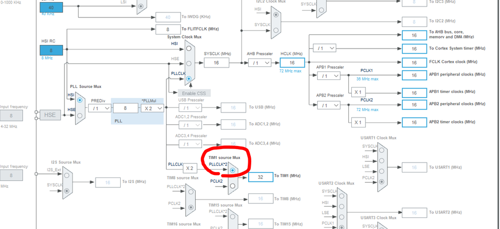

I never actually implemented it, but I know it's supposed to be possible to have the timer clocked at 144MHz whilst the core is running at 72MHz.

As Chris said, many 'F3 do have this feature, for TIM1/TIM8 and in F303xDxE also TIM15/16/17/20. This is a quite unique property of the 'F3 family, a feature not very well sold by ST.
PLL's VCO probably runs at 2x the "official" output frequency, and the system output is unconditionally scaled /2, while the TIM1/8 output can be optionally divided or not. This also explains the USB clock, which is also said to be divisible by 1.5 (i.e. the non-scaled PLL output which is "oficially" x2 is divided by 3).
