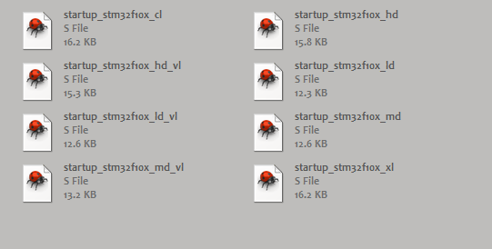

Hello friends
 I hope all is good
i have Problems in choosing startup from StdPeriph_Lib my MCU is STM32f103vct6
Which should I use and why?

    Google STM32F103VC, it's a High-Density part
    http://www.st.com/en/microcontrollers/stm32f103vc.html
    startup_stm32f10x_hd.s

    What's hd_vl ?

    Here ST's explanation from their
    stm32f10x.h
    file (guess it causes the post to go into moderation, too):
      /* ♯ define STM32F10X_LD */     /*!< STM32F10X_LD: STM32 Low density devices */
      /* ♯ define STM32F10X_LD_VL */  /*!< STM32F10X_LD_VL: STM32 Low density Value Line devices */
      /* ♯ define STM32F10X_MD */     /*!< STM32F10X_MD: STM32 Medium density devices */
      /* ♯ define STM32F10X_MD_VL */  /*!< STM32F10X_MD_VL: STM32 Medium density Value Line devices */
      /* ♯ define STM32F10X_HD */     /*!< STM32F10X_HD: STM32 High density devices */
      /* ♯ define STM32F10X_HD_VL */  /*!< STM32F10X_HD_VL: STM32 High density value line devices */
      /* ♯ define STM32F10X_XL */     /*!< STM32F10X_XL: STM32 XL-density devices */
      /* ♯ define STM32F10X_CL */     /*!< STM32F10X_CL: STM32 Connectivity line devices */
    /*  Tip: To avoid modifying this file each time you need to switch between these
            devices, you can define the device in your toolchain compiler preprocessor.
     - Low-density devices are STM32F101xx, STM32F102xx and STM32F103xx microcontrollers
       where the Flash memory density ranges between 16 and 32 Kbytes.
     - Low-density value line devices are STM32F100xx microcontrollers where the Flash
     - Medium-density devices are STM32F101xx, STM32F102xx and STM32F103xx microcontrollers
       where the Flash memory density ranges between 64 and 128 Kbytes.
     - Medium-density value line devices are STM32F100xx microcontrollers where the
     - High-density devices are STM32F101xx and STM32F103xx microcontrollers where
       the Flash memory density ranges between 256 and 512 Kbytes.
     - High-density value line devices are STM32F100xx microcontrollers where the
     - XL-density devices are STM32F101xx and STM32F103xx microcontrollers where
       the Flash memory density ranges between 512 and 1024 Kbytes.
     - Connectivity line devices are STM32F105xx and STM32F107xx microcontrollers.
