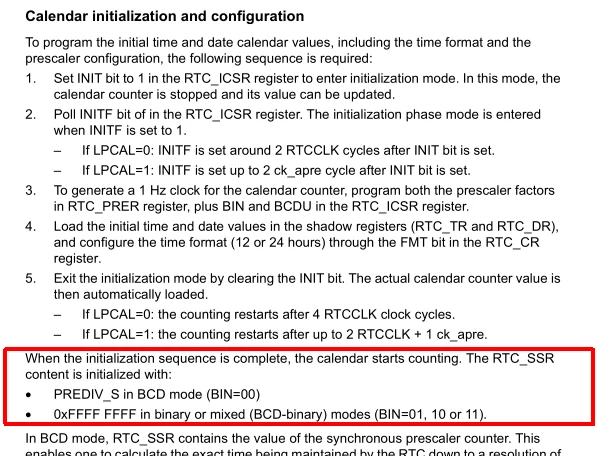

RTC3 of some newer STM32s introduce a RTC mixed mode, where both binary part (32-bit down-counting sub-seconds register SSR) and classic BCD calender (TR/DT) mode are operational.
In my case I am using this for classic style BCD alarms together with binary mode timers used by the CubeMX generated LoRaWAN stack.
This works perfectly fine until I try to set the BCD calender time part with HAL_RTC_SetTime.
It turned out, that as soon as RTC->TR is written, RTC->SSR is reset to 0xFFFFFFFF. As all timers backed by the binary mode rely on some SSR timestamp, they fail.
I tried backing up SSR and writing back after RTC->TR write, but it seems to be read-only.
Am I missing something? If a mixed mode has been introduced, I doubt normal behaviour is that the BCD part cannot be set anymore without affecting the binary mode part.
Best answer by waclawek.jan
This matches the description in RM:
The reason for this is to ensure that the first calendar (seconds) increment happens exactly one second after the initialization is finished (i.e. that the calendar can be run sub-second perfect).
I don't know what that exactly means, but the possible workaround would probably be related to shifting those "timers" (which I presume are some software constructs) appropriately.
surumadurum
March 29, 2024
Ok, I see, thanks a lot!
Yes, this workaround would probably work, thanks for the suggestion. I took the other route now and decided to go with binary mode all along and calculate hh:mm style alarms myself.
