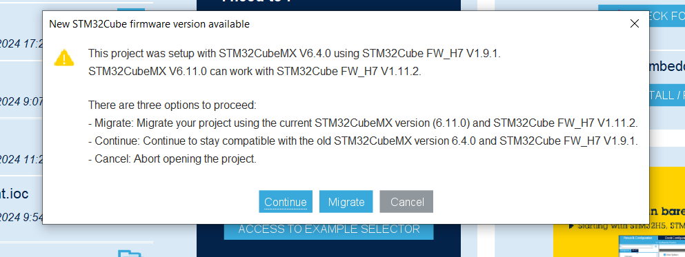

Thanks for your helpful reply, It is all working fine now. The Ethernet port on my laptop was not on the same Gateway.
Regarding the Firmware 1.11.2 that I have mentioned, I have another project using STM32 H series Micro, every time I open it, CubeMX prompts a message about migrating the project to a newer version or continue as you can see in the screenshot. I didn't notice that CubeMX uses different firmware for each device. my bad!
